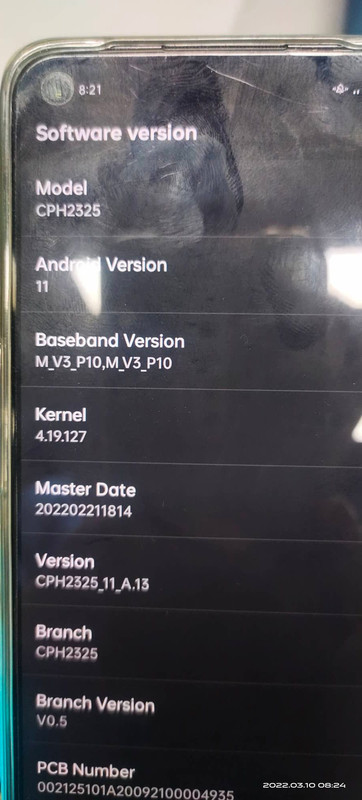

oppo A55 CPH2325

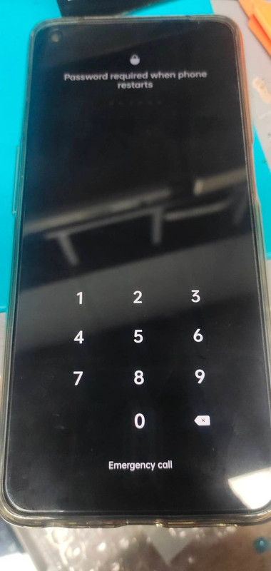

problem;
password after resset password frp
solution
sa password just wipe data by recovery...
alam muna yan kung legit ka magic finger
after format in recovery found out na may FRP
tried solution in mic but no luck same din sa paglagay ng sim na may password no luck again...

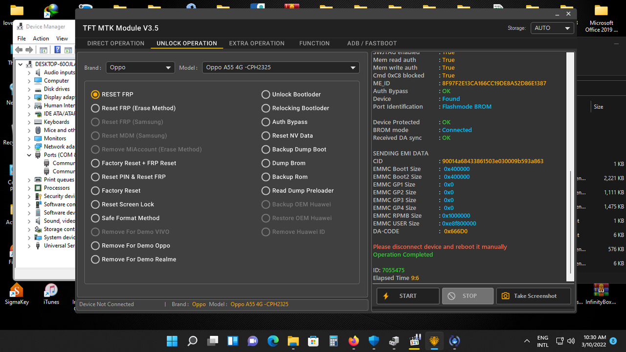

here the solution tested sa frp
logs
============== Software Info ==============
TFT MTK Module -- v3.5
Current version : 3.5
User : DESKTOP-60OJLAR
License : Activated
LocalTime : 3/10/2022 10:26:28 AM
OS : Microsoft Windows 11 Pro
OS System : 64 Bit
TFT is Supported with Windows:
============== Operation Info ==============
Preparing Path ..........OK
Reading data ..........OK
Operation Reset FRP
Brand : Oppo
Model : Oppo A55 4G -CPH2325
How To Boot : Power off phone
* BROM Mode : Press VOL + or Press VOL -+
* Preloader Mode : Just Insert cable
Waiting For Device Connection.....
Device : Found
Port Identification : Flashmode BROM
CPU : MT6765(Helio P35/G35)
Disabling Watchdog... : OK
HW CODE : 0x766
SBC enabled : True
SLA enabled : False
DAA enabled : True
SWJTAG enabled : True
Mem read auth : True
Mem write auth : True
Cmd 0xC8 blocked : True
ME_ID : 8F97F2E13CA166CC19DE8A52D86E1387
Auth Bypass : OK
Device : Found
Device Protected : OK
BROM mode : Connected
Received DA sync : OK
SENDING EMI DATA
CID : 90014a68433861503e030009b593a863
EMMC Boot1 Size : 0x400000
EMMC Boot2 Size : 0x400000
EMMC GP1 Size : 0x0
EMMC GP2 Size : 0x0
EMMC GP3 Size : 0x0
EMMC GP4 Size : 0x0
EMMC RPMB Size : 0x1000000
EMMC USER Size : 0xe8f800000
DA-CODE : 0x666D0
Please disconnect device and reboot it manually
Operation Completed
Elapsed Time 9:6

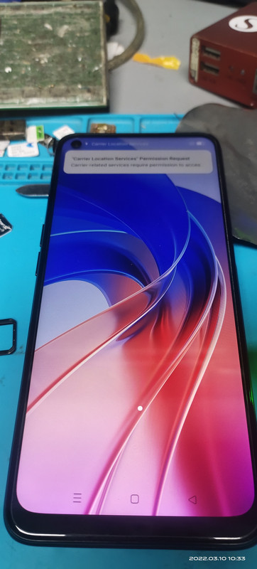

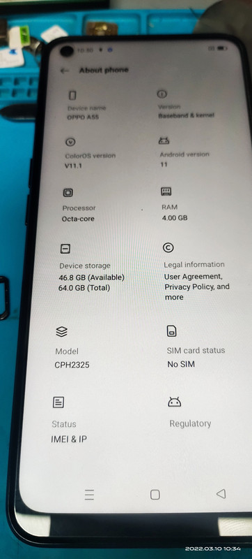

meron na dito yan sa ating tahanan search and download nalang..
finish product
