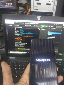

PROCEDURE AGAD
OPEN HYDRA MTK
BRAND OPPO
MODEL CPH1909 A5S
OFF PHONE
TICK BOOT INFO
HOLD +-VOL
CONNECT USB WIRE (vocc)
After info
drop down under Tools
Ultra Power
tick EXECUTE AKO :D
DONE
