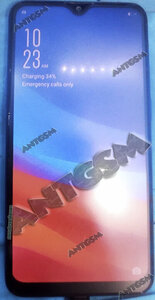

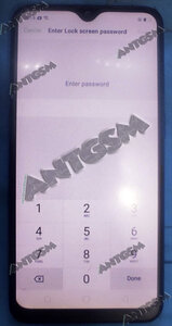

Problem : Lock Screen & Frp
Tools : Data Cable & Octoplus FRP Tool

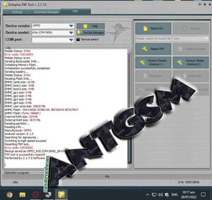

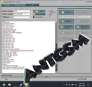

Procedures: On FRP tab Select
  1. Device Vendor : OPPO
  2. Device Model : A5s (cph1909)
  3. Click Factory Reset (Method 1)
  4. Turn Off phone then hold both volume - & volume + then insert data cable. Release the buttons after detection.
  5. After Successful reset turn on phone then go to Emergency dial then dial *#813#.
