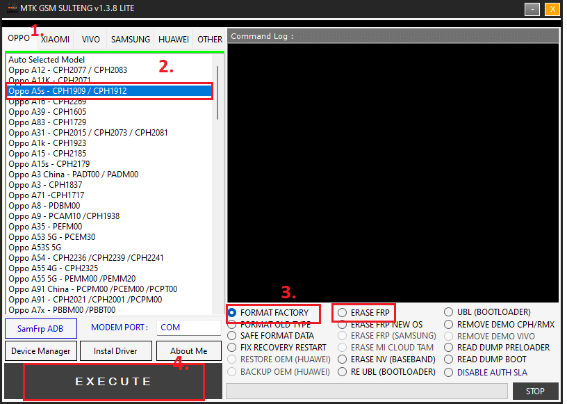

SignUp Now!Dapat sinama mo na sir ung software ginamit mo.. ?1. Open GSM Sulteng, Select exact model then proceed to Format Factory.
2.Same process sa FRP, proceed to Erase Frp.
3.pag boot up,dial lang sa emergency ang *#813#View attachment 22996

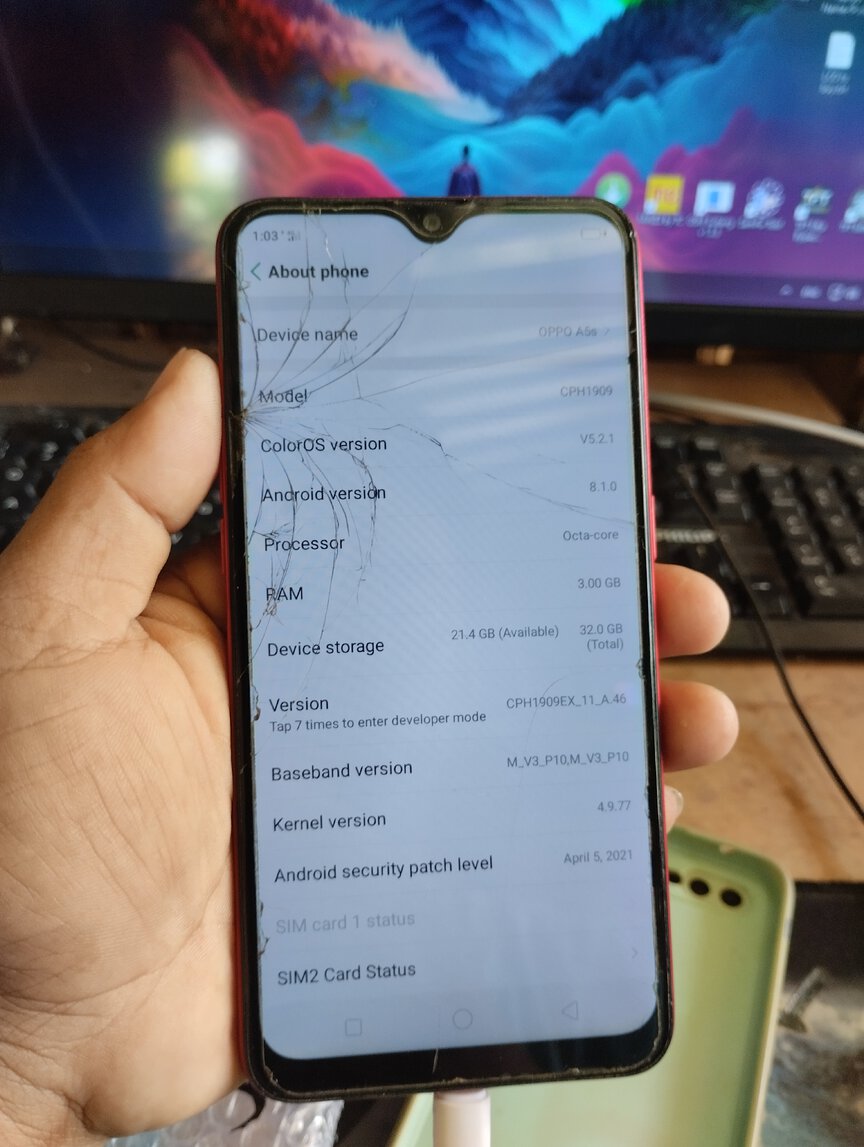

salamat sir ok napo unit ng client <3Dapat sinama mo na sir ung software ginamit mo.. ?
