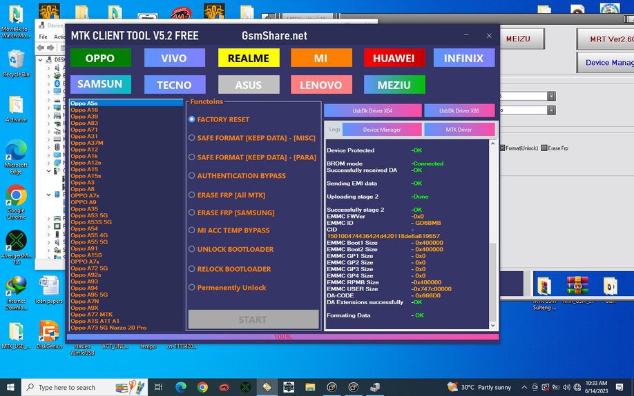

1st open mtk client tool v5.2 free tool
2nd locate it in to oppo and select a5s
3rd set in factory reset
4rt vol/up hold at the same time and press start button and insert the usb cable
and it will run just like in picture until say factory data -ok
5th restart the phone and for frp *#813# at the emergency
