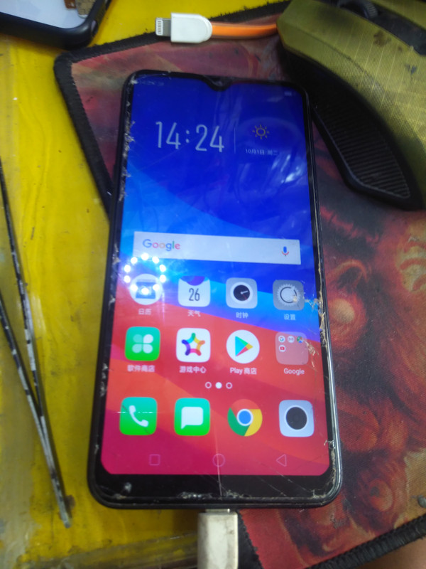

Oppo A5s Passcode problem
Mediatek

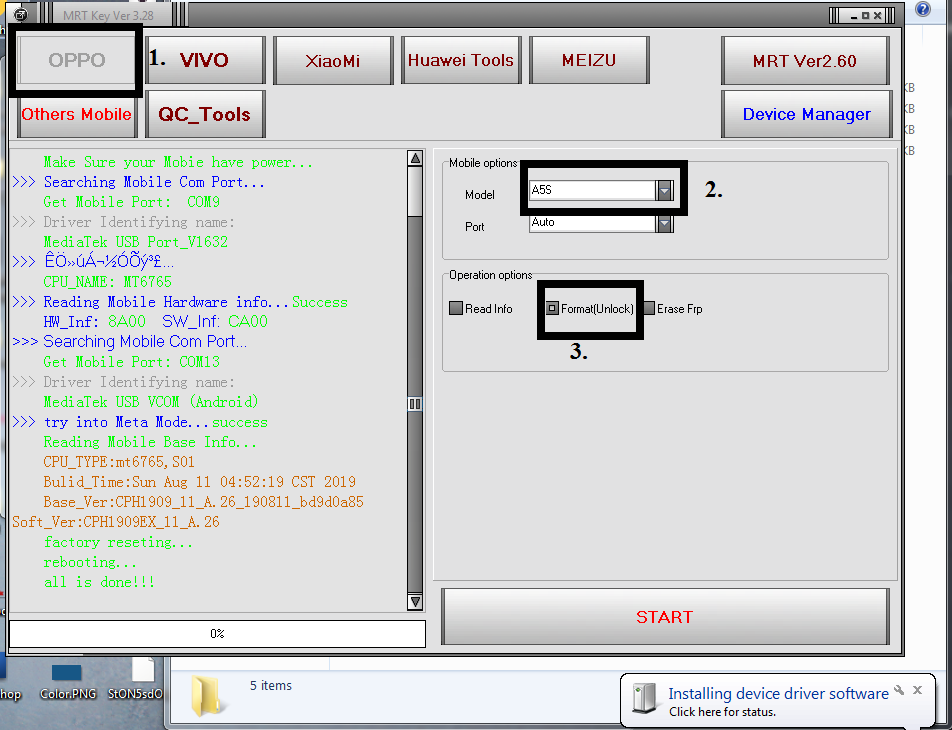

1st install drivers if needed
2nd open MRT
3rd Set to OPPO Find (A5S Model) and tick Format
Tick Start

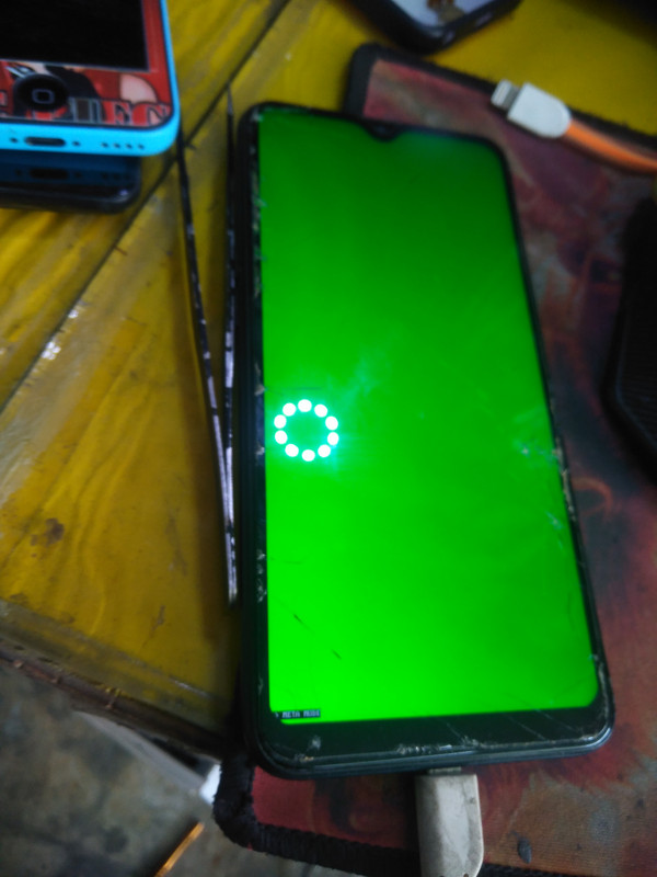

Hold Vol up and down for couple of seconds
For FRP
Just dial *#812#
Sana makatulong mga sir.
