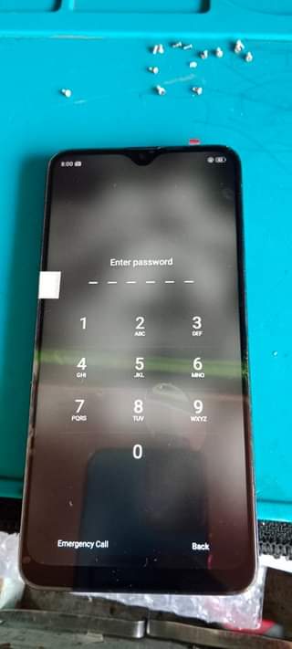

PROCEDURE
OPPO A5S PASSWARD
BY UNLOCK TOOLS
OPIN UNLOCK TOOLS

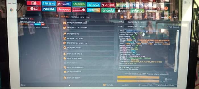

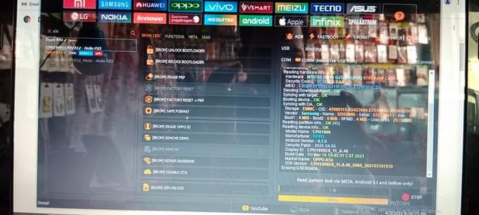

CLICK OPPO TAB
SEARCH OPPO A5S CPH 1909
THEN HOLD VOLUME UP DOWN
CONNECT USB CABLE
CLICK BROM FACTORY RESET
WAITING DONE
FRP *#813#
done
