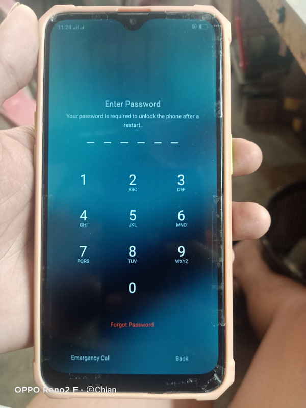

Good day po sa inyong lahat. Today may tanggap po akong oppo a5s password problem

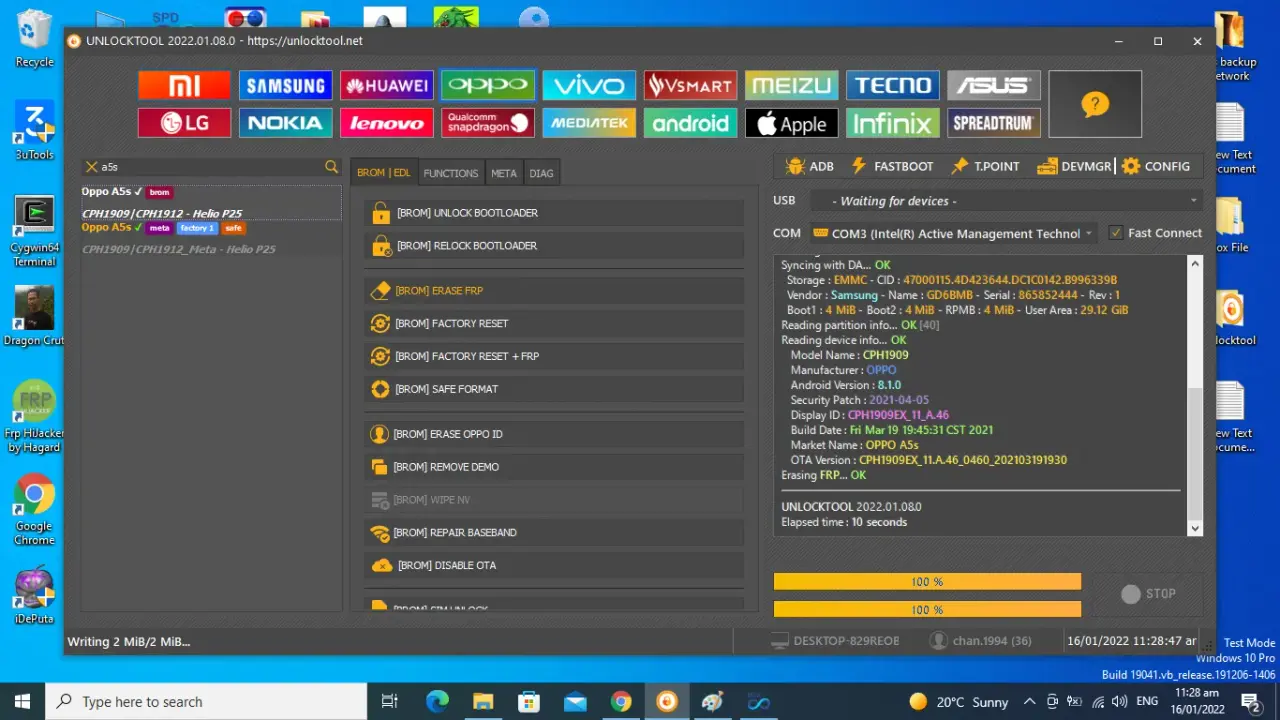

Open unlocktool select brand 'OPPO' search model 'A5S' (BROM) and click [BROM] SAFE FORMAT. Now turn off phone and hold volume up and volume down then insert usb cable and wait until it done then next after ma boot turn off ulit. Open ulit si unlocktool and click [BROM] ERASE FRP and insert usb cable and wait until it done

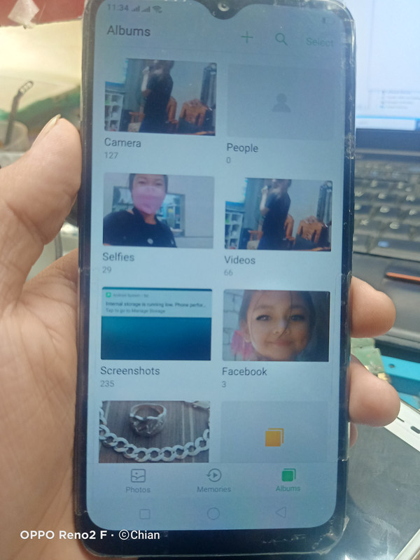

Heto naman po ang proof ko
