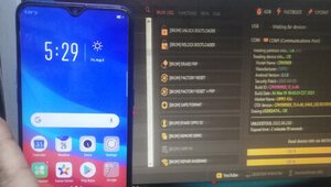

REFERENCE OPPO A5S PATTERN+FRP DONE KE UT

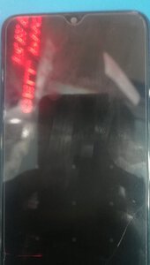

Procedure: 1.Open Unloctook exe. 2.Select Oppo Tab. 3.Select A5s/ brom. 4.Saksak USB. 5.Boot key vol up and down 6.Wait until Down. 7.pag oks n ung pass or pattern. 8.dial *#812# callIMG_20220806_081418.jpgIMG_20220806_081348.jpg
