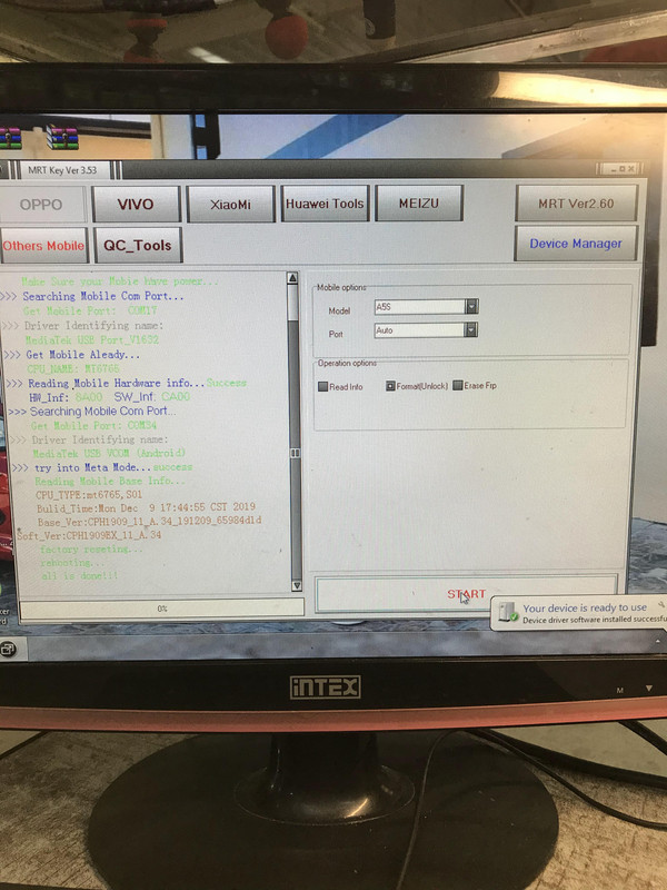

1.OPEN MRT KEY
2.CLICK OPPO TAB
3.SET MODEL TO A5S
4.PORT SHOULD BE AUTO
5.POWER OFF PHONE
6.HOLD VOL + AND VOL- THEN INSERT CABLE
7.WAIT UNTIL MAG START NA MAG READ THEN TSAKA BITAWAN
8.AUTO RESTART AFTR FINISH,
9.PAG MAY FRP CICK EMERGENCY AT TYPE *#812* AND CALL AUTO OK NA PO YAN,SET MO NA LANG LANGUAGE LODI..
SALAMAT
sir bakit sa akin na detect na ng pc ang vcom pero pag search metamode na yung hinahanap ng mrt di sya ma detect naka metamode naman yung phone phone na a5s mrt crack gamit ko
