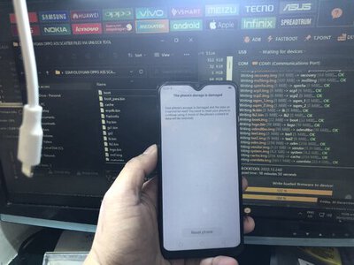

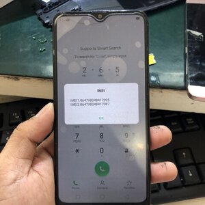

OPPO A5S SCATTER FILE BACKUP VIA UNLOCKTOOL
PAALALA: BACKUP MUNA BAGO FLASH
FEEDBACK NAMAN KONG TESTED

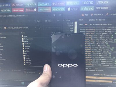

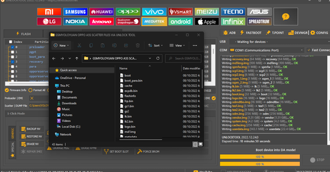

READ BACK Initializing usb... OK
Waiting for device... COM12 [BOOTROM:0E8D:0003]
Bypassing authentication... OK
Analyzing... preloader_oppo6765_18511.bin [MT6765:9:1552] [Internal]
Vendor : OPPO/REALME
Handshaking... OK
Reading hardware info... OK
Hardware : MT6765 [Helio G25|G35|P35] 0766 8A00 CA00 0000
Security Config : SCB SLA DAA
MEID : E0AD385DAFA1EE6C47D1ED8BB91928CA
Sending Download-Agent... OK
Syncing with target... OK
Booting device... OK
Syncing with DA... OK
Storage : EMMC - CID : 684A0190.50613842.31AD033E.C36698B0
Vendor : SK Hynix - Name : hB8aP> - Serial : 2561683885 - Rev : 3
Boot1 : 4 MiB - Boot2 : 4 MiB - RPMB : 16 MiB - User Area : 29.12 GiB
Reading partition info... OK [40]
Reading device info... OK
Model Name : CPH1909
Manufacturer : OPPO
Android Version : 8.1.0
Security Patch : 2021-04-05
Build ID : CPH1909EX_11_A.46
Build Date : Fri Mar 19 19:45:31 CST 2021
Market Name : OPPO A5s
OTA Version : CPH1909EX_11.A.46_0460_202103191930
Reading preloader [512 KiB] -> preloader.bin... OK
Reading pgpt [32 KiB] -> pgpt.bin... OK
Reading boot_para [1 MiB] -> boot_para.bin... OK
Reading recovery [64 MiB] -> recovery.img... OK
Reading para [512 KiB] -> para.bin... OK
Reading opporeserve1 [8 MiB] -> opporeserve1.img... OK
Reading opporeserve2 [64 MiB] -> opporeserve2.img... OK
Reading oppo_custom [1 MiB] -> oppo_custom.bin... OK
Reading expdb [20 MiB] -> expdb.bin... OK
Reading frp [1 MiB] -> frp.bin... OK
Reading nvcfg [32 MiB] -> nvcfg.img... OK
Reading nvdata [64 MiB] -> nvdata.img... OK
Reading metadata [32 MiB] -> metadata.img... OK
Reading protect1 [8 MiB] -> protect1.img... OK
Reading protect2 [8.47 MiB] -> protect2.img... OK
Reading seccfg [8 MiB] -> seccfg.bin... OK
Reading persist [48 MiB] -> persist.img... OK
Reading sec1 [2 MiB] -> sec1.bin... OK
Reading proinfo [3 MiB] -> proinfo.bin... OK
Reading md1img [100 MiB] -> md1img.img... OK
Reading spmfw [1 MiB] -> spmfw.img... OK
Reading scp1 [6 MiB] -> scp1.img... OK
Reading scp2 [6 MiB] -> scp2.img... OK
Reading sspm_1 [1 MiB] -> sspm_1.img... OK
Reading sspm_2 [1 MiB] -> sspm_2.img... OK
Reading gz1 [16 MiB] -> gz1.bin... OK
Reading gz2 [16 MiB] -> gz2.img... OK
Reading nvram [64 MiB] -> nvram.img... OK
Reading lk [5 MiB] -> lk.bin... OK
Reading lk2 [5 MiB] -> lk2.bin... OK
Reading boot [32 MiB] -> boot.img... OK
Reading logo [16 MiB] -> logo.bin... OK
Reading odmdtbo [16 MiB] -> odmdtbo.img... OK
Reading tee1 [5 MiB] -> tee1.img... OK
Reading tee2 [9 MiB] -> tee2.img... OK
Reading odm [256 MiB] -> odm.img... OK
Reading vendor [1.31 GiB] -> vendor.img... OK
Reading system [4.2 GiB] -> system.img... OK
Reading cache [256 MiB] -> cache.img... OK
Reading userdata [22.4 GiB] -> userdata.img... OK
Reading otp [43 MiB] -> otp.img... OK
Reading flashinfo [16 MiB] -> flashinfo.img... OK
UNLOCKTOOL 2022.10.05.2
Elapsed time : 6 minutes 30 seconds
