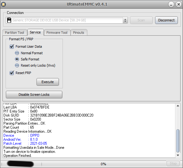

REFERENCE OPPO A7 CPH-1903 PATTERN REMOVE DONE
13
1,022
1,035
ijebel
Dec 8, 2015
156
Opening Device...Done
Physical Details:
Chip Size : 0xE8F800000 [58.24 GB]
Sector Size : 0x0200
Sector Count : 0x0747C000
Reading Partition Data...OK
Header Rev. : 0x00010000
Header Size : 0x5C
Header CRC : 0x3E11637F
Current LBA : 0x00000001
Backup LBA : 0x0747BFFF
First LBA : 0x00000022
Last LBA : 0x0747BFDE
PIT Entry Size : 0x80
Disk GUID : 321B1098E2BBF24BA06E2BB33D000C20
Parsing Partition Entries...OK
Part Count : 65
Reading Device Information...OK
Device : OPPO
Android Ver. : 8.1.0
Patch Level : 2021-03-05
Formatting Userdata in Safe Mode...Done
Turn on device to finalize operation.
Operation Finished.
Gumagamit ako ng umt sa pamamagitan ng isp kailangan mong i-activate ang emmc module
