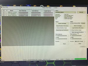

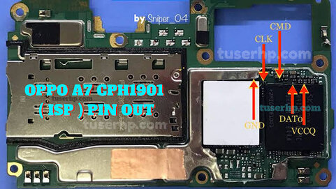

Share ko lang po cph1903 password remove by efixer tool
Eto po yung pinsout

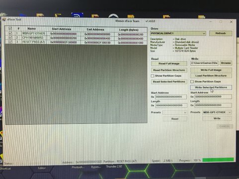

Sunod po open efixer tool
Click - Refresh
Click - Read partition
structure
Click - browse - open the cph1901 reset passcode bin file
Click - load partition structure
Click - write selected partitions
Done na po
Tested ko na po sa cph1903 kahit cph1901 ginamit kong bin file.

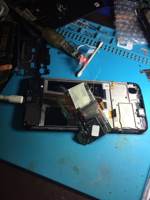

Pasensya na po wala ako picture ng unit kasi po excited si costumer umalis.

idol bka pwde mka hinge ng file A7 cph1903.salamat
boss kasama ba yung VCCQ pin? sa A3s kc hindi na kasama SALAMT PO
up ko lng to mga boss ask ko lng kilangan ba lahat nakahinang pin out para magconect oppo a7 ,...
