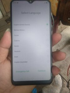

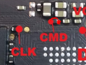

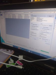

Click - Refresh
Click - Read partition
structure
Click - browse - open the cph1901 reset passcode bin file
Click - load partition structure
Click - write selected partitions

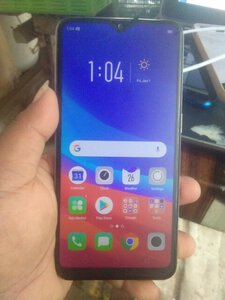

Done na po
Tested ko na po sa cph1903 kahit cph1901 ginamit kong bin file.
