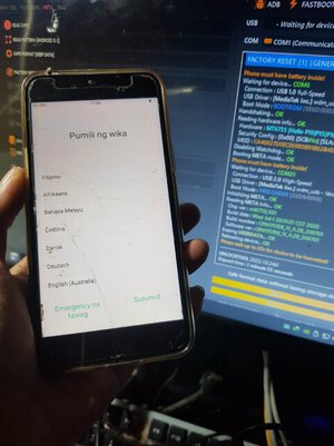

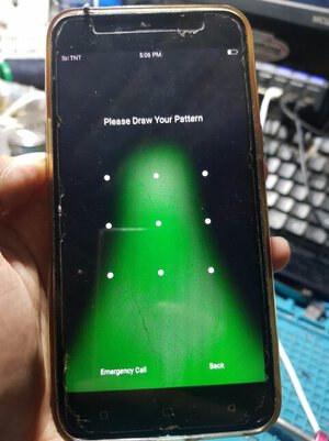

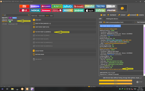

OPEN UNLOCK TOOL
CLICK OPPO TAB
SEARCH OPPO A71 CPH 1717
CLICK START
HOLD VOL + AND -
SALPAK USB WAITNG HANGGANG MATAPOS.
FOR FRP DIAL *#813#
SANA MAKATULONG NEWBIE LANG PO :)
