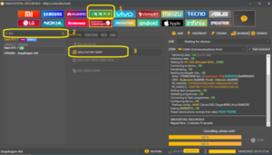

1.Run UT
2.Off ang unit then
3.Hold volume- and volume +
on UT select Oppo
search A71
EDL factory reset then
pic na po procidure
frp *#813#
Sana makatulong
Finish Pro.
