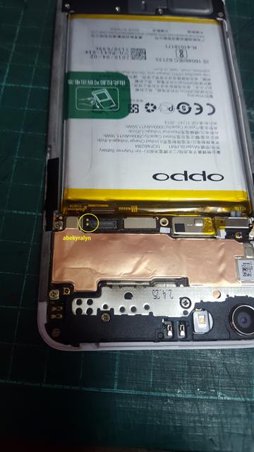

KUNG WALA TWISTER NLNG PARA SA TESTPOINT

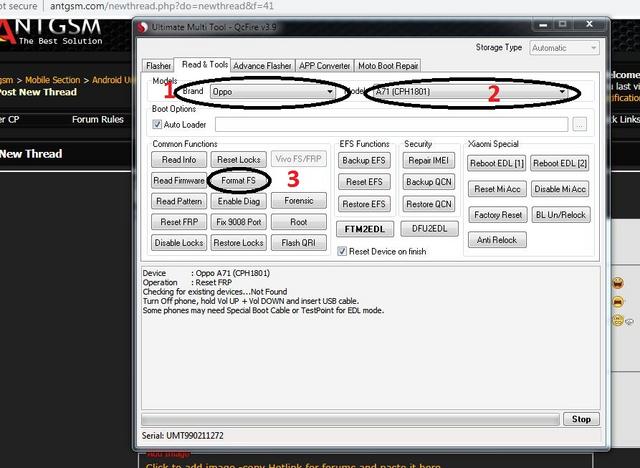

Open Ultimate Multi Tool - QcFire
select brand
model
click Format fs
pres vol up and down sabay salpak EDL cable
note: kung walang edl operation baklas gamit twiser para sa testpoint
RESULT DONE:
