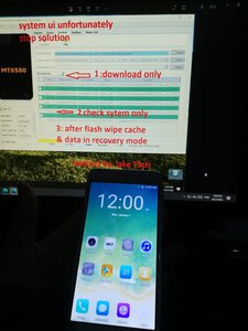

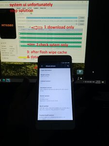

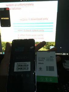

oppo a77 plus clone force System ui unfortunately stop solution
ito gamit kong firmware
https://www.mediafire.com/file/r7va...1__ALPS.L1.MP6.V2_YUANDA6580.WEG.L_P2.7z/file

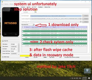

1: open SP Flash tool
2: select scatter file
3: select download only
4: uncheck all box except sa System
5: Tick Download then hold volume up then insert usb cable
6: punta ka sa recovery mode, Wipe mo Cache at Data
Done na
Hit like kung naka tulong​
