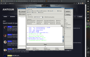

Oppo A83 (2018) Passcode Problem
Solution : Format in Mrt via TP
Procedure :
Open Mrt - Tick MTK Special Tool - Format Unlock - EMMC_Flash_Init_1 - OPPO only
Click Start :
ito testpoint niya :
Done :)
