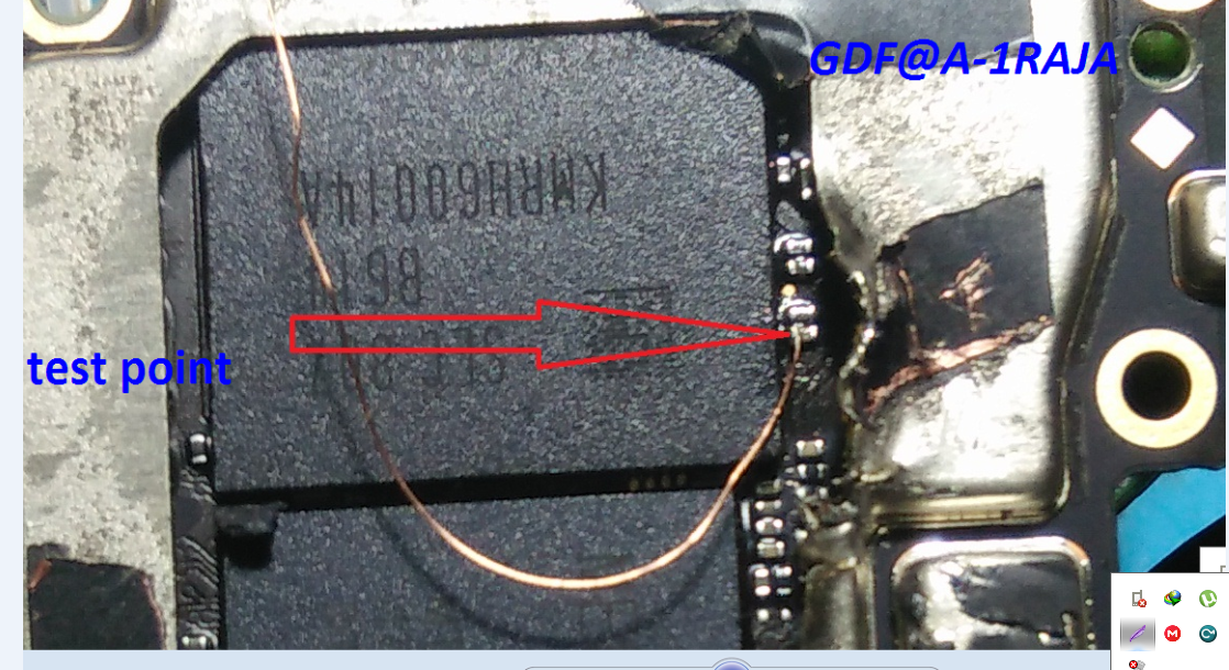

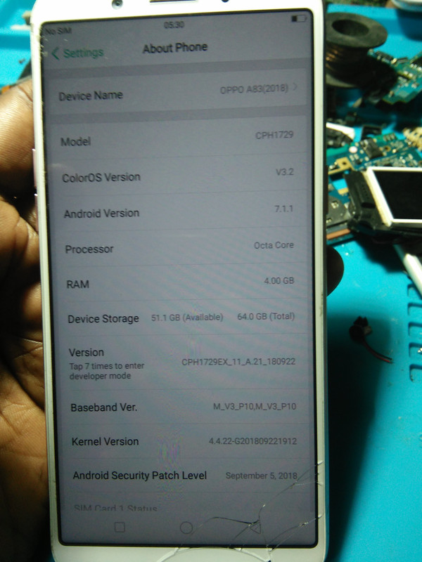

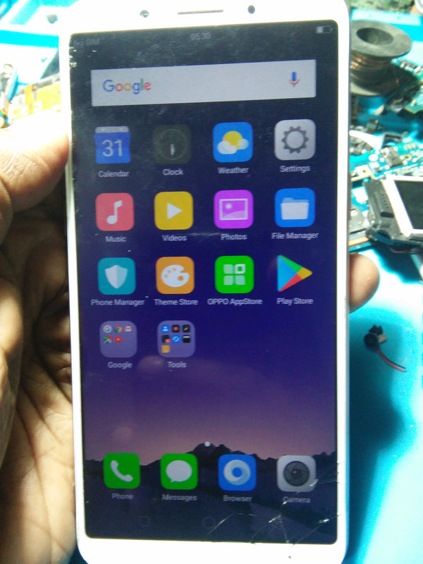

OPPO A83 2018 New boot cph1729 pattern unlocked via test point

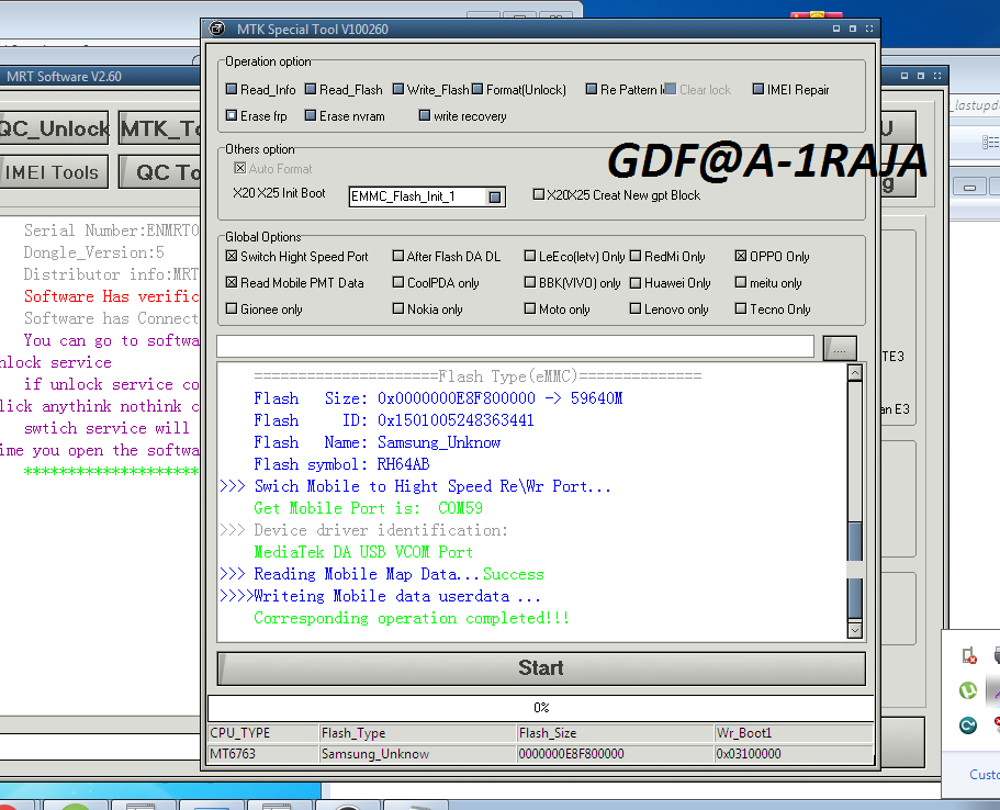

pattern lock remove Log
Quote:Disconnect Mobile...
Re-Put the Mobile Bettery...
Then Connect your Phone to Computer again....
Please Make sure Mobile better has Power...
>>> Searching Mobile Port...
Get Mobile Port is: COM76
>>> Device driver identification:
MTK USB Port
>>> Mobile Has Connect...
CPU_NAME: MT6763
>>> Reading Mobile Hardware Info...Success
HW_Inf: 8A00 SW_Inf: CA01
>>> Initialization Mobile ...>>> Sending Auth File To Mobile...Success
>>> Downloading Boot1 To Mobile Phone...Success
Mobile phone status:SYNC...
Mobile phone status swtich to :brom...Success
Make sure Mobile status has in :brom...
Init Mobile BOOT2 ...
=====================Flash Type(eMMC)==============
Flash Size: 0x0000000E8F800000 -> 59640M
Flash ID: 0x1501005248363441
Flash Name: Samsung_Unknow
Flash symbol: RH64AB
>>> Swich Mobile to Hight Speed Re\Wr Port...
Get Mobile Port is: COM59
MediaTek DA USB VCOM Port
>>> Reading Mobile Map Data...Success
>>>>Writeing Mobile data userdata ...
Corresponding operation completed!!!

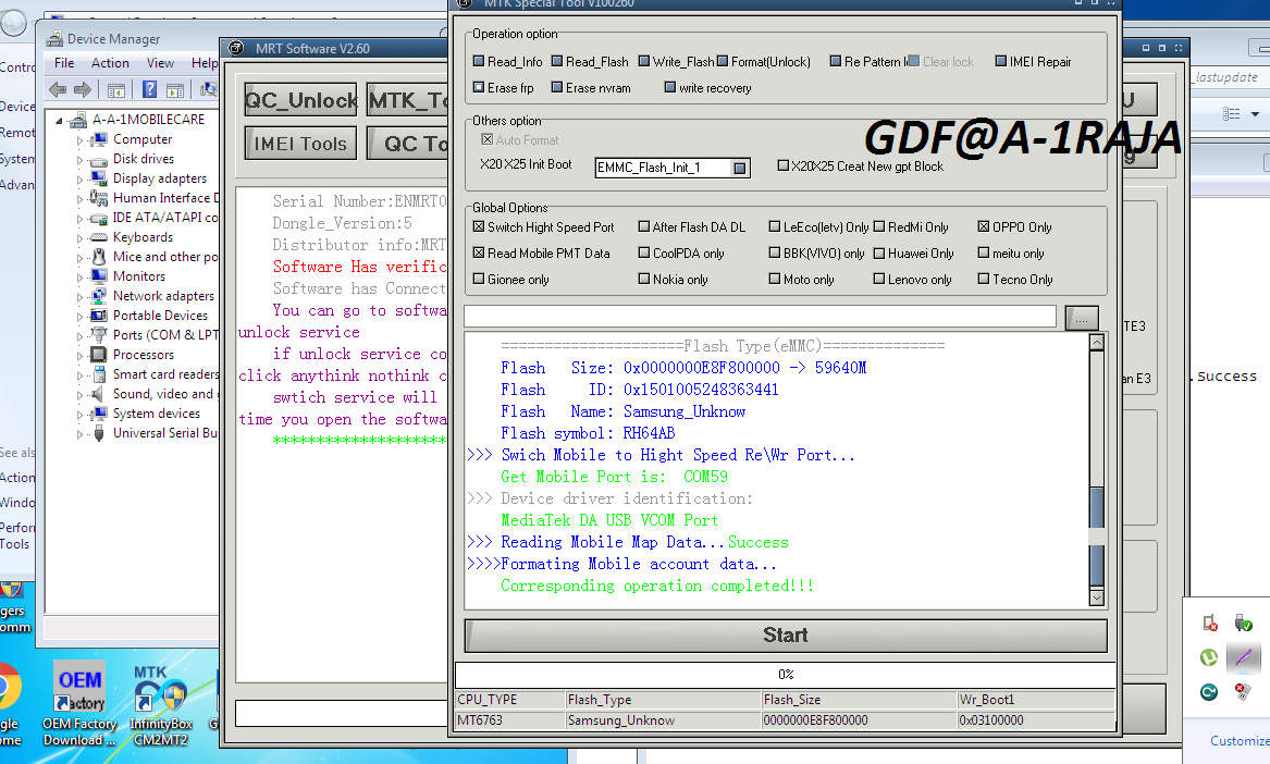

Frp Remove log
MTK USB Port
CPU_NAME: MT6763
>>>>Formating Mobile account data...
