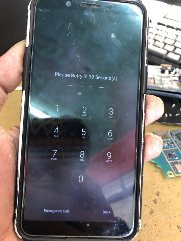

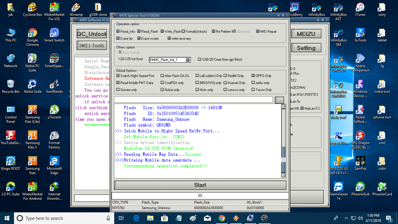

Oppo A83 password and frp by MRT TP
password via tp

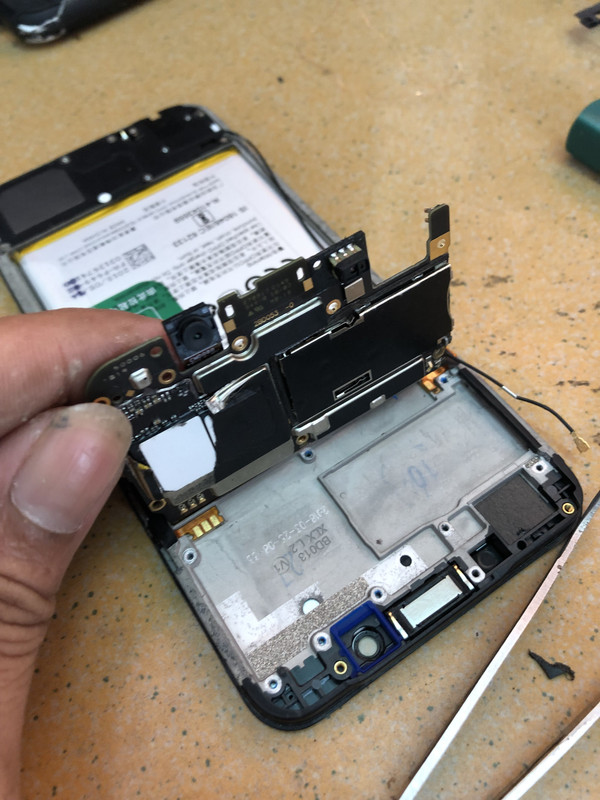

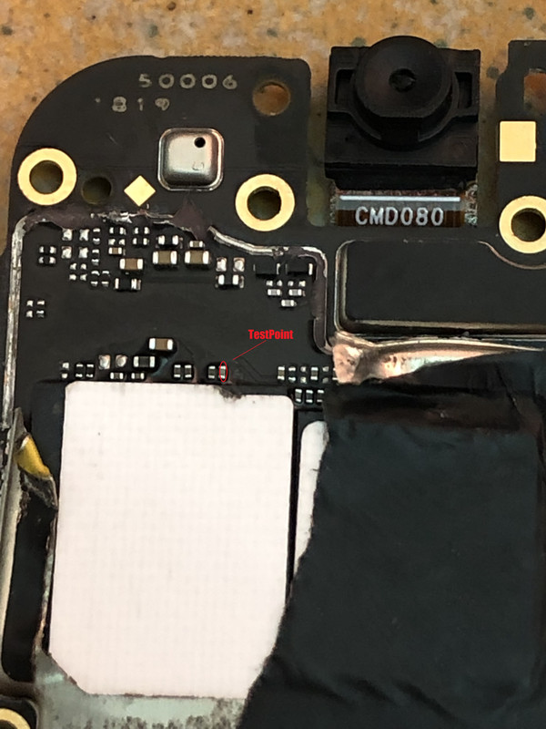

1st diassemble tp to ground ganito ginawa ko with battery and twizer

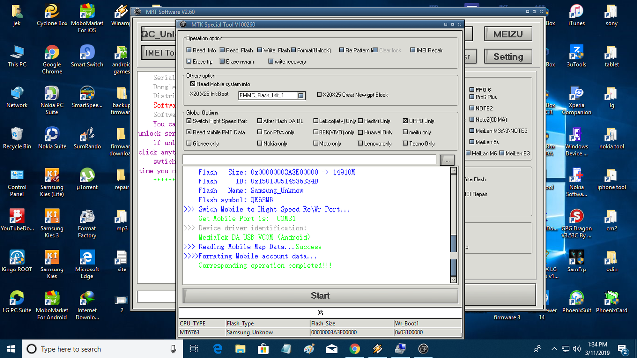

2nd.open mrt 2.60
mtk tool format unlock oppo only and start tp to ground wait u lang gang madetect if d magconect remove battery then insert gain usb and tp to ground....

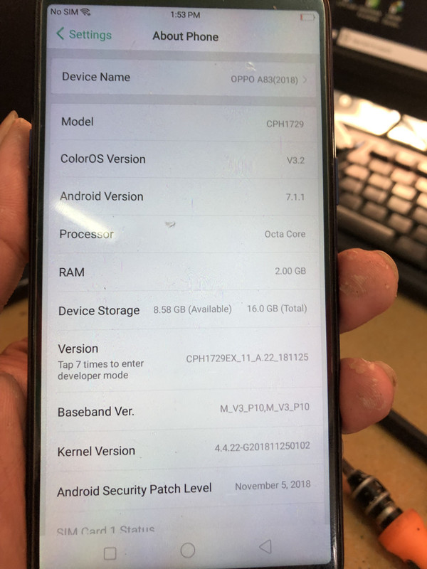

done...

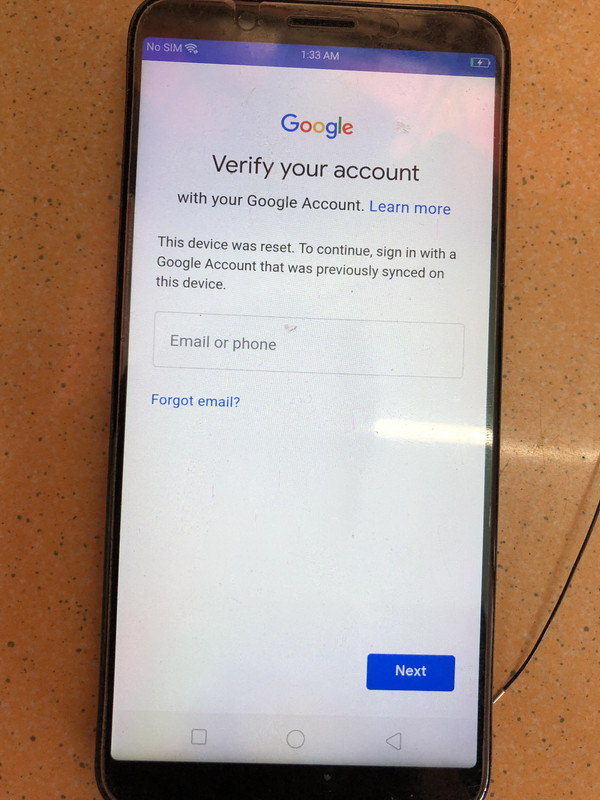

FRP naman tulad lang din sa una ginawa ko erase frp...
thanks antgsm....
