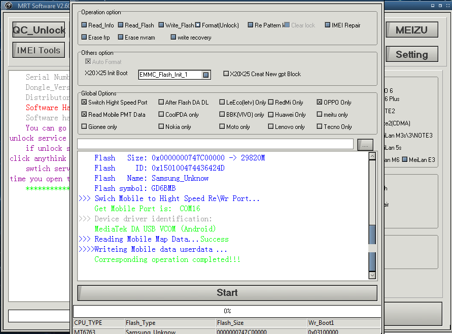

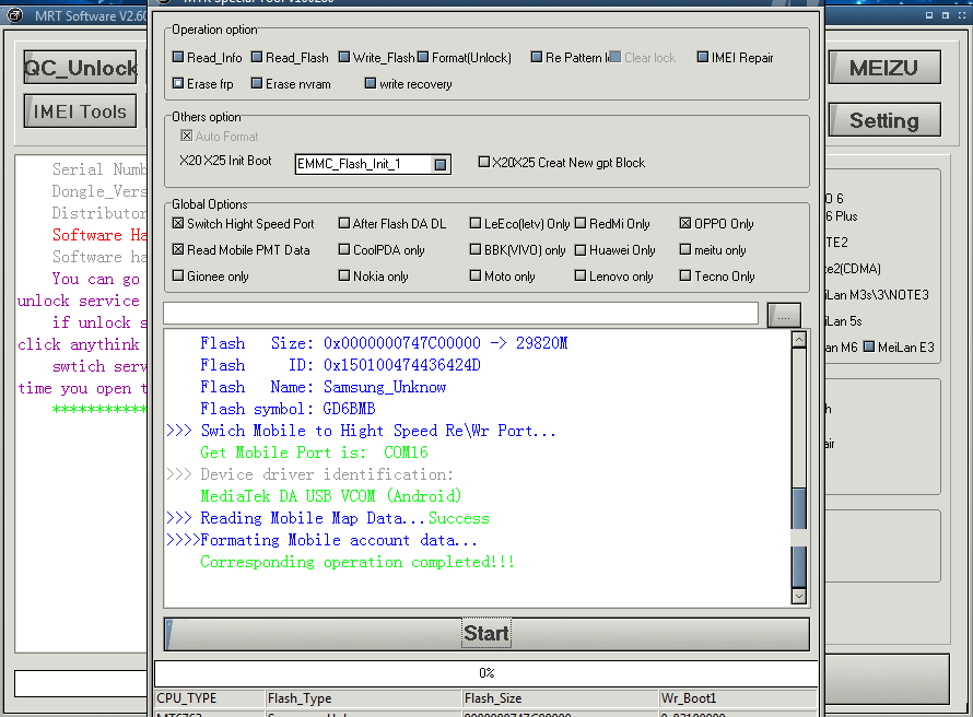

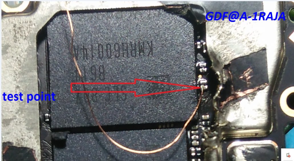

Share ko lang Oppo A83 password and frp...
procedure
Connect TP to ground
hold vol- & + inset usb
pag nagboot or nagconnect sa mrt tanggalin si tp
wait matapos
done!!
