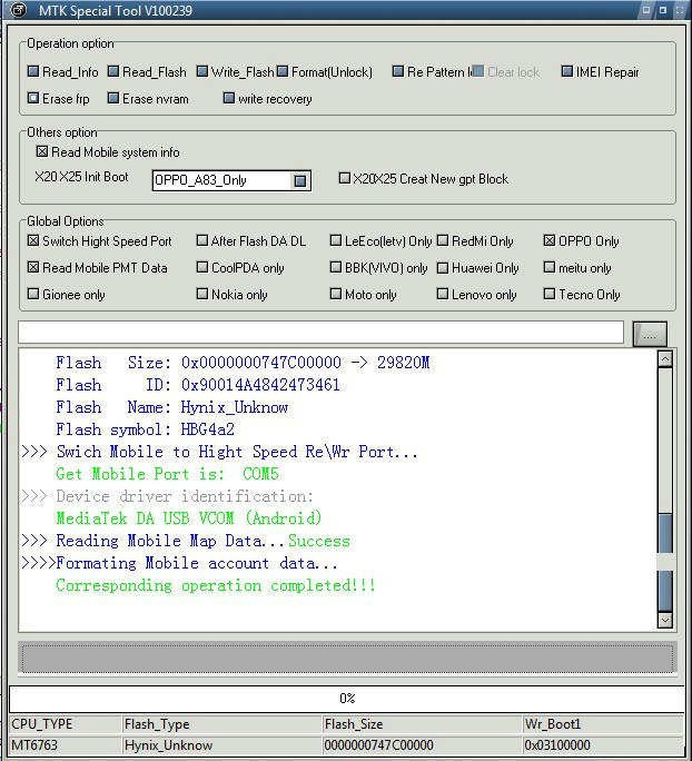

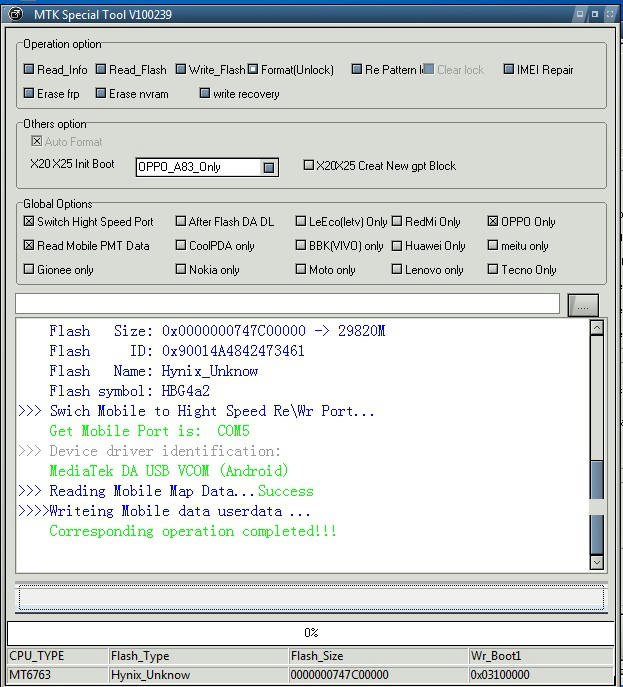

Procedure: Open MRT tool
Select tab -Unlock/Format
then click below oppo only
then select exact model A83
click start and then press Vol+ and Vol.- and connect urt cable to phone and w8 to start detect the
phone wait till message pop up successfully completed
Done:):):)

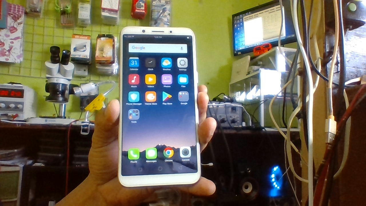

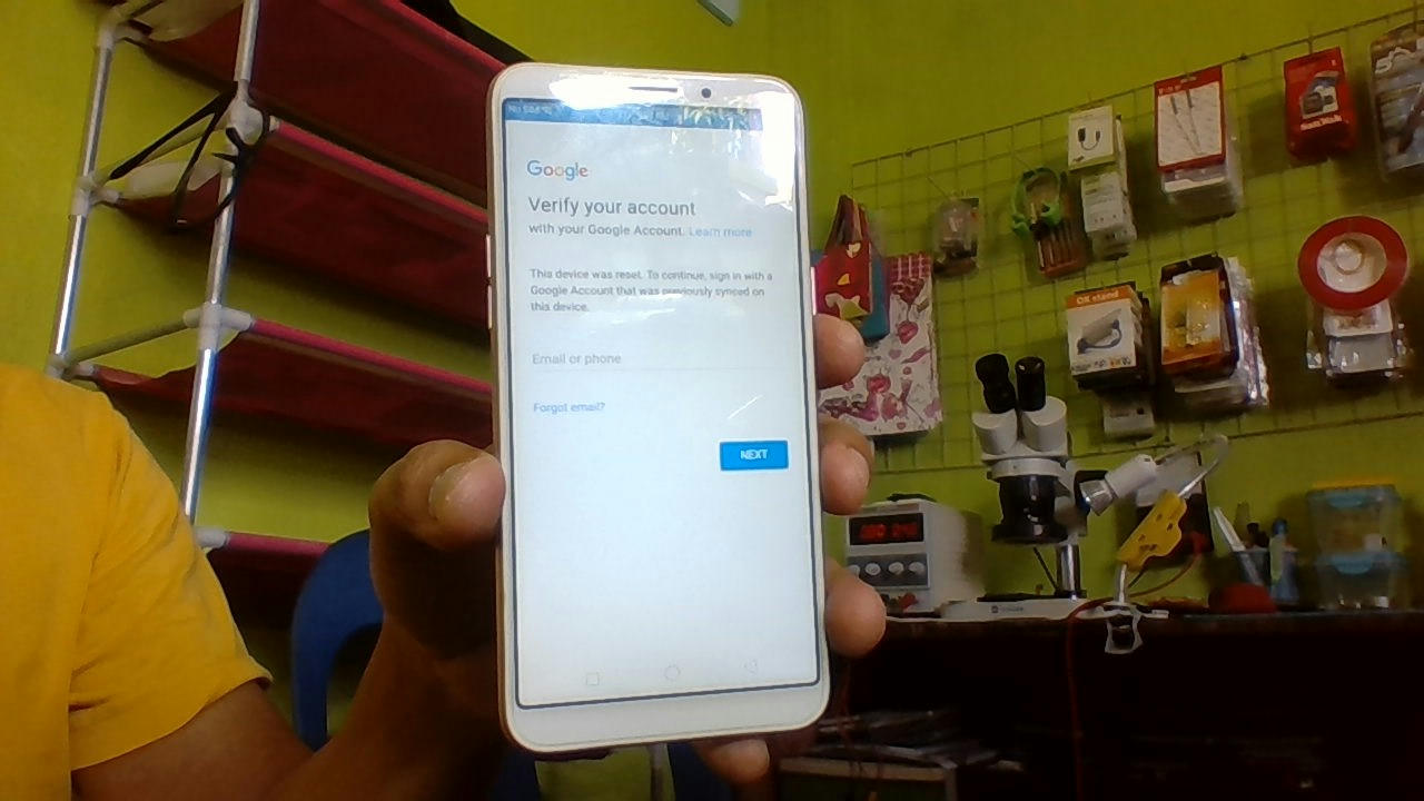

Screen shots:
For referrence Only.. Thanks for viewing:)
