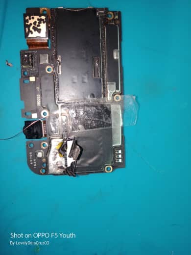

Walang Coder na Mahagilap kaya Tiyaga Muna sa test point...
Dito ko Kinuha Testpoint at Procedure..

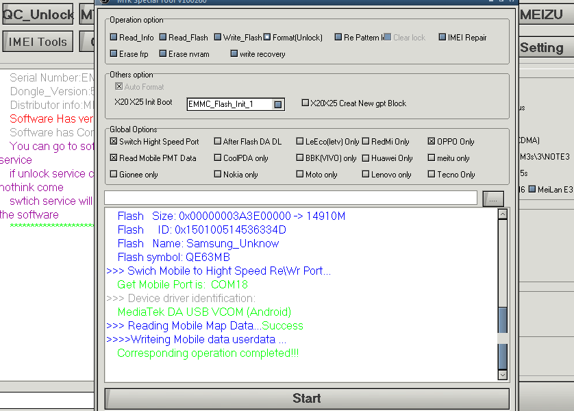

Open Mrt 2.60 ginamit ko..
Tapos Mtk Tools
Set Oppo Only , Emmc_Flash_Init_1
Tick Format (unlock)
After Maformat Alisin na muna TestPoint Bago Buhayin..

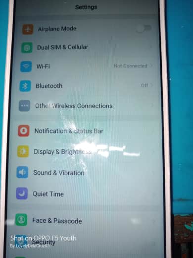

Pag Nabuhay na May FRP pa yan...
Dial nalang *#812# then Call...
Magiging Intsik xa Set nlng sa English...
And You're Done...
PS:malayo Kuha ng Jumper Wala akong CP na Mganda Ayaw mag autofocus
