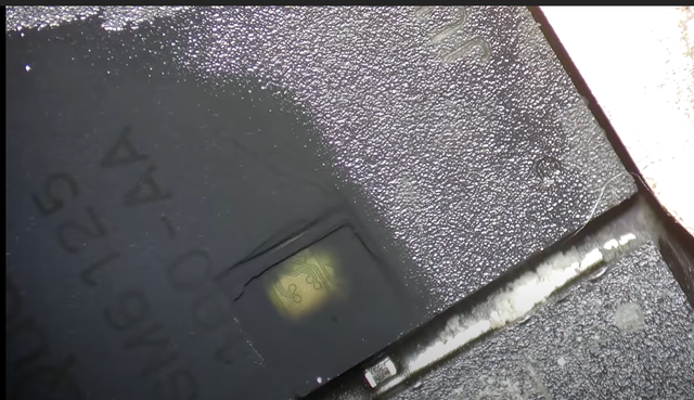

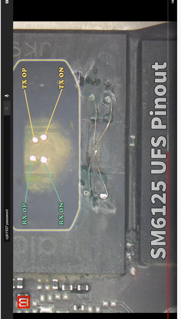

Type *#899# check product code CPH1937 oppo a9
check tested ISP
hinang ng maayos
open Easy Jtag plus software
select UFS
under ng UFS tab select Andriod
under ng Andriod Tab select RESET OPPO
DOne
