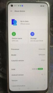

Oppo A94 CPH2203 Erase Password & Frp Done By Unlocktool
-Hard Reset For Password
*Press Vol Down + Power
-Wipe Data
-Format Data

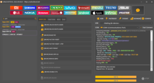

-For FRP
-Open Unlocktool
-Oppo
-Search a94
then Select Oppo A94 or A95 5G
-Click [BROM] ERASE FRP
-Bootkey Vol up & down
