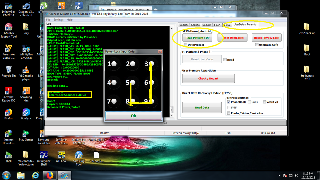

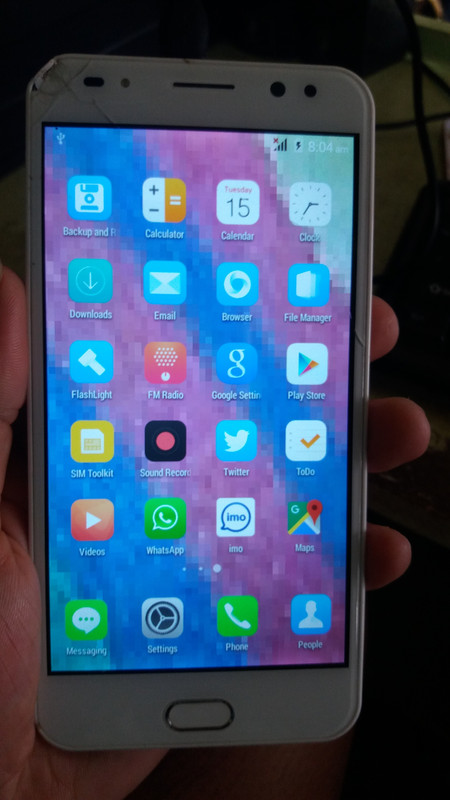

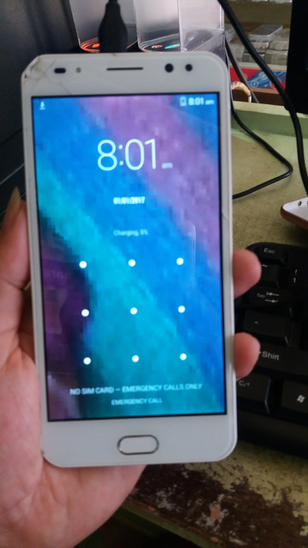

share ko lang mga boss oppo f1s clone may pattern done very easy without loosing any files sa cm2mtk..
pakisundan nlang yung pics andyan na po ang procedure..
-Open CM2MTK
-Select 2nd option in CPU/Chipset
-Select UserData/Forensic
-Hit Read Pattern/DP
-Turn Off the phone & insert USB cable.
