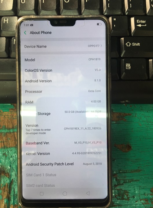

Oppo F7 (CPH 1819)
Nireset daw at gusto nila mabura lhat ng file
kya pagkareset humihinge ng Google account (FRP)

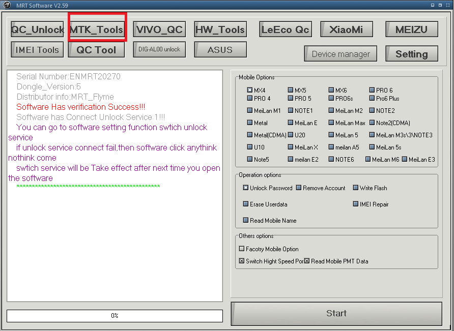

kaya procede na sa MRT
1.Open
2.Tick Mtk Tools

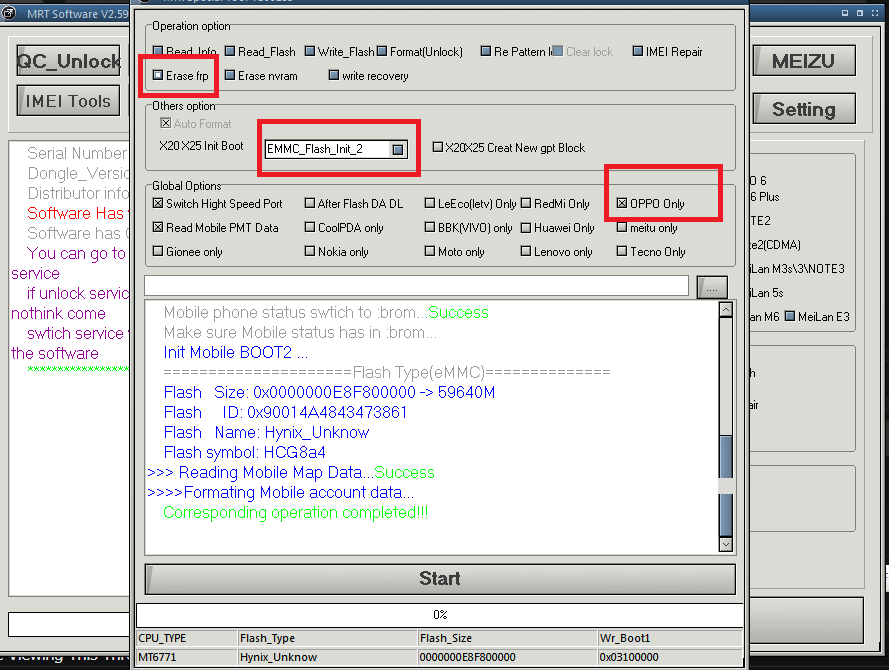

3. Select Erase FRP , Select Emmc Flash ini 2 , Oppo Only
As shown on picture
4. Press Start
5. Press and Hold Both Volume "+ -"
at hintay ka na nlng....
