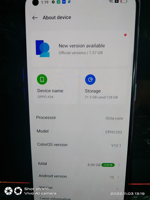

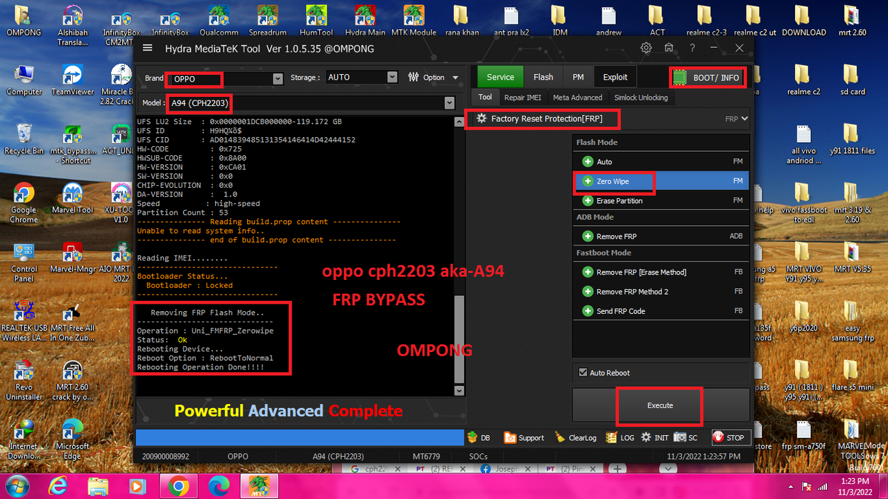

1,REMOVEpassword muna off unit then press v-and power botton insert code to format data
2,bypass frp
3,open hydra mtk select model
4,boot info mo muna power off unit press v- v+
5,pag tapos boot info wag mo galawin unit yaan mo naka
salpak sa cable, select factory reset protection then execute
ass in cute ako,,,,haha

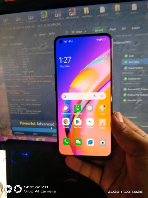

note,, first try ko ok sa tools pero pag dating sa unit my frp pa din
tapos inulit ko uli yung procedure at ayun nakulitan bumigay din,,
