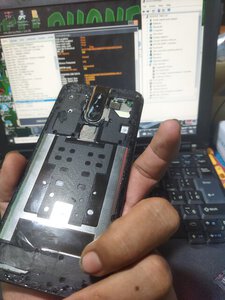

Oppo f11pro some application forcly closed
Pag inoopen nag cocled din both camera not working galery d maopen minsan auto restart no specific time pag nag restart
Fix kay fix kay GSM SULTENG, link nandito na po sa tahanan search nyu lang po gsm sulteng
Dko na napicturan every single details pero surely tested po
Open, mo si gsm sulteng
Click FORMAT FACTORY
turn off ang unit pindutin ang volume down and up ng sabay at saksak usb cable.
Salamat sa tahanan,
