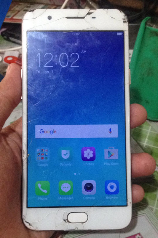

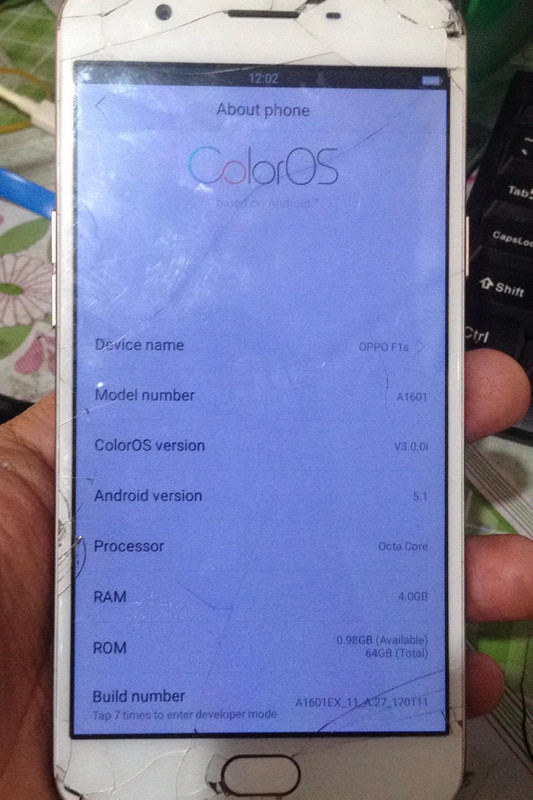

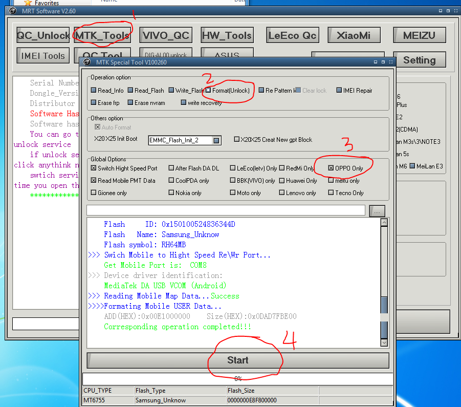

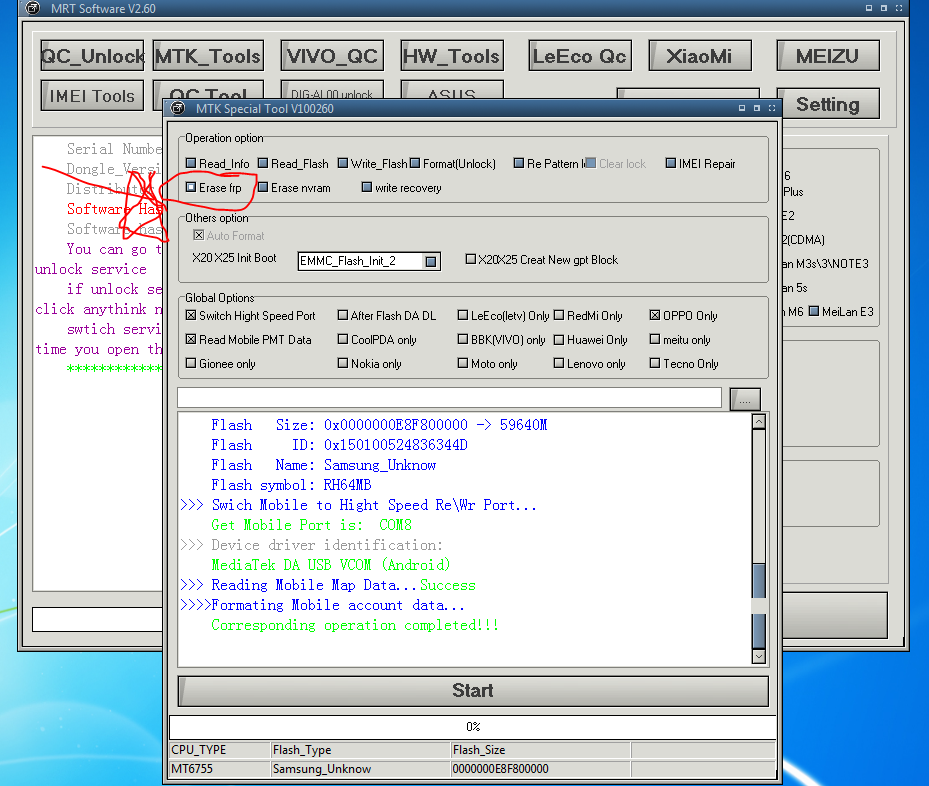

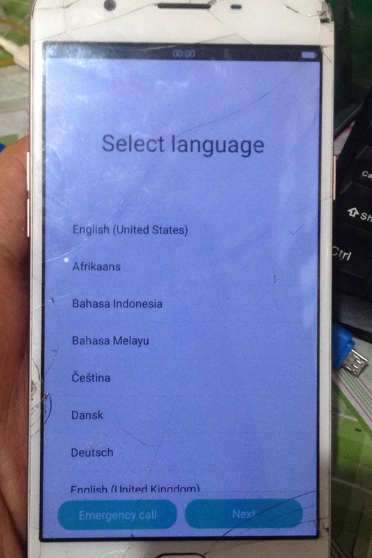

samzhen_23 Registered Joined Oct 9, 2014 Messages 983 Reaction score 224 Points 81 Location bunsuran 3rd pandi bulacan Feb 25, 2019 #1 Oppo F1s 1601 pattern lock share ko lang oppo f1s pattern nakalimutan pati gmail open mrt tool follow nlng screenshots pattern remove hold HOLD VOLUME tapos saksak sa usb para basahin.. frp remove same procedure done done for reference only thanks for viewing Last edited by a moderator: Jun 21, 2019
