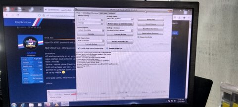

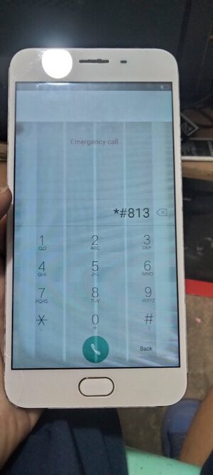

procedure:
off windows security set up yung crack next2x mo lng lagay mo yung password setup drox
open nck tool crack windows 11 o 10 mn yan ios gamit mo gagana yung crack

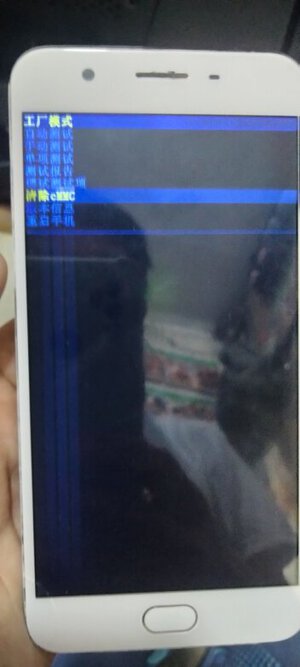

Main : MT6580
Service : reboot phone [ factory reboot ] [reboot phone in selected Mode ] click
hold voll up lagay usb wait ... mag reboot ang pon lalabas yung chinese letter
gamitin mo yung voll down piliin mo yung my MMC power button mag rereboot ang unit
ok na frp *#813# :
Main : MT6580
ok na frp *#813# :
