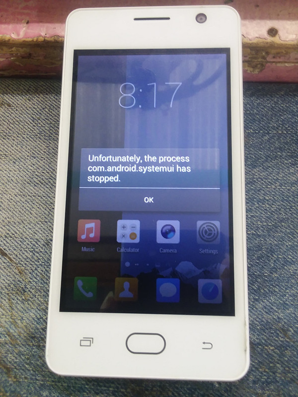

REFERENCE oppo f3 mini monkey virus done no using firmware. format user data nck crack.

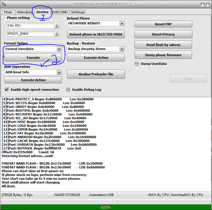

-Open NCKBox AndroidMTK
-Select Service Tab
-Select MT6571_EMMC in phone settings
-Under Format Option select Format_UserData
-Hit Execute Button under Format Option.

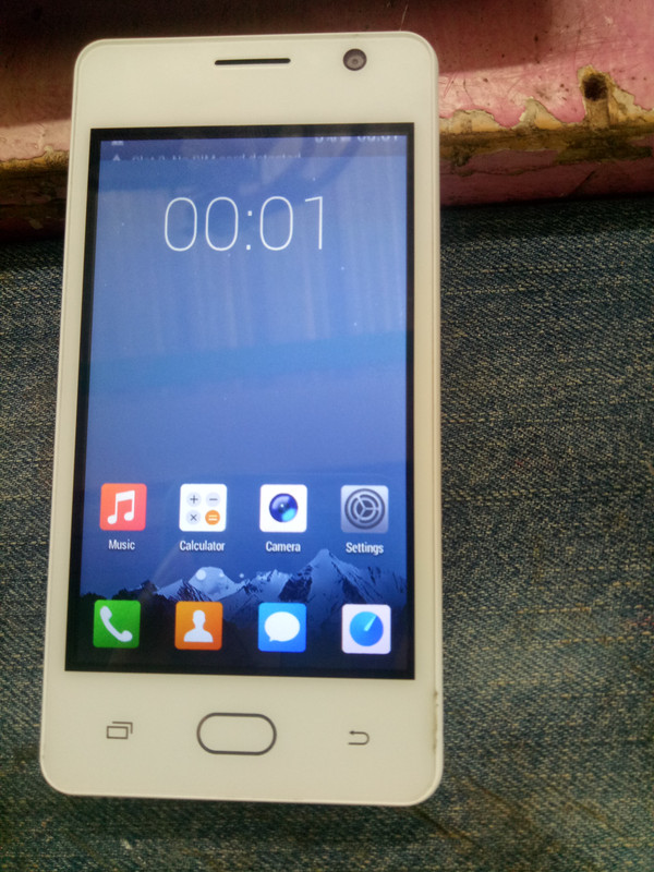

pag Unfortunatley lalo pag mga china phone mas maganda eflash para dina bumalik si 2mer pag 4mat lang kasi babalik ang problema nya mas maganda program basta may same Firmware ng model.
