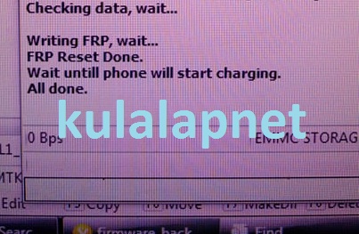

REFERENCE Oppo F3 Pattern and FRP done in Nckbox
9
117
126
kulalapnet
Nov 22, 2014
464
/open nckbox androidmtk
/select Oppo F3 model
/goto Utils
/select Factory Reboot
/on phone
/select Clear EMMC
/wait phone to reboot
/done
logs:
Selected flash metod: FACTORY REBOOT
Please note, not all phones support this mode
Scanning for presents meta ports...
Phone must be off with battery inside.
Please insert USB cable now...
In some phones need to keep VOL- button untill inserting USB cable.
[23]Detected: MTK USB Port (COM23)
\\?\usb#vid_0e8d&pid_0003#5&21616667&0&1#{a5dcbf10-6530-11d2-901f-00c04fb951ed}
Starting FACTORY MODE, wait...
If need to make phone factory reset, scroll to line what have EMMC in name and execute.
In some phones factory menu can start after 5-30sec.
All done.
