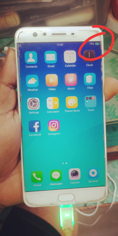

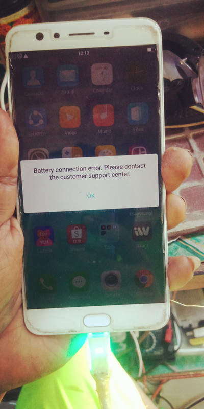

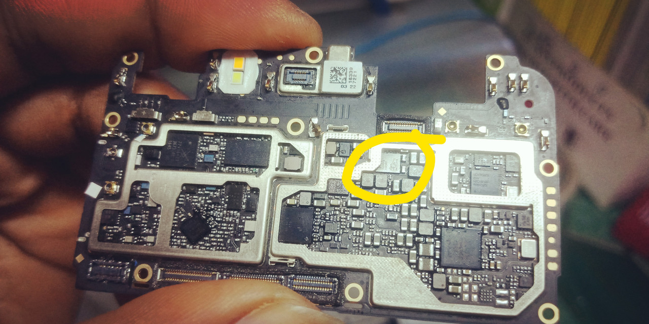

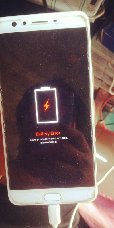

Z zerimar Registered Joined Apr 10, 2017 Messages 254 Reaction score 196 Points 1 Location tuguegarao,cagayan May 29, 2020 #1 oppo f3 plus battery connection error done painitan ng katamtaman lng or replace ic na sa baba Last edited by a moderator: May 31, 2021

JERSAM Expired Account Joined Jan 28, 2019 Messages 158 Reaction score 54 Points 201 Location tanza cavite May 31, 2021 #9 salamat po sa tut mo idol..tested 100 % sa akin,,kagawa lang,,reheat only

alex_gg06 Registered Joined Jan 8, 2022 Messages 16 Reaction score 8 Points 1 Location Taguig City, Metro Manila Mar 1, 2022 #11 saan pwede makabili ng mismong ic? kahit kc irebal at tanggalin ung coil may battery error pa din
Jhanny19 Expired Account Joined May 6, 2015 Messages 20 Reaction score 2 Points 201 Location RIZAL Jan 6, 2023 #12 alex_gg06 said: saan pwede makabili ng mismong ic? kahit kc irebal at tanggalin ung coil may battery error pa din Click to expand... same issue sa akin boss tinanggal ko dn coil ok nmna,after 2weeks ganun dn bumalik ulit, ano mgandang gawin mga bossing?
