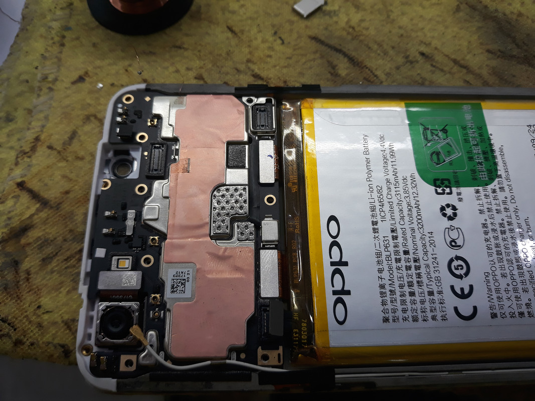

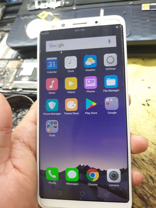

FIRST POH BAKLAS PHONE AT T.S. PO ITO...

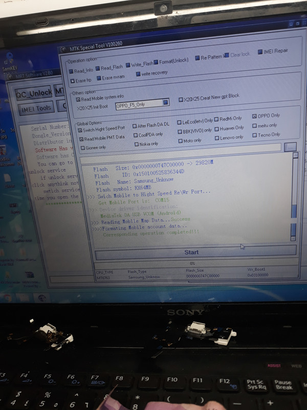

1->tools mrt dongle

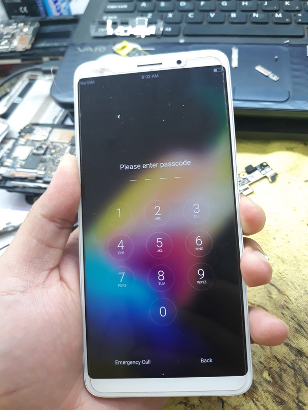

2->problem password/frp
3->open mrt special tool select f5 only
popular baby names 1890

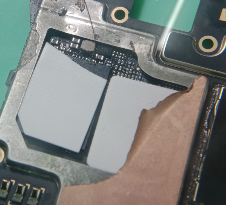

4->connect t.p. to ground click start then salpak usb....
note error po lahat ng tools dito kaya try ko sa testpoint hindi naman ako nabigo......
sa frp naman poh pag error ulitin lng poh...tp salpak usb pag detect na tanggal ka agad tp..para iwas error....cnxa poh...fisrt post ko poh to...salamt...
