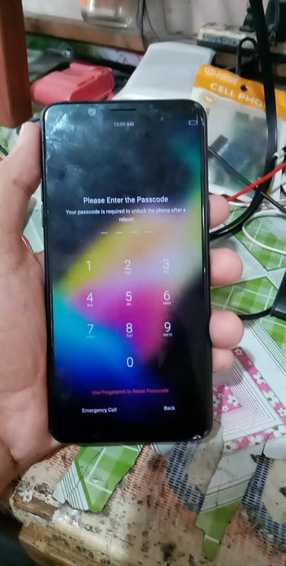

OPPO F5 YOUTH (1725) PASSWORD FRP DONE MRT DONGLE

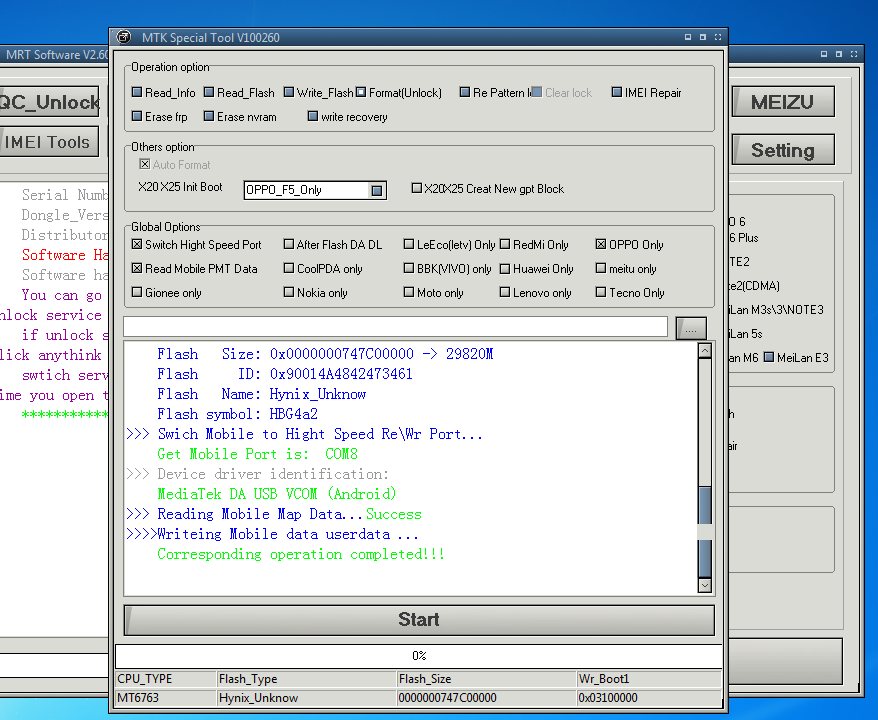

screenshots procedure
open mrt dongle
tick mtk tab
tick unlock format
choose on global option oppo only
choose model f5
baklas phone

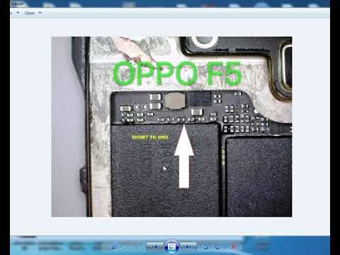

boot by tp
jumper sa ground
dito ko medyo nahirapan kasi nag eerror
tricks
then pag nadetect na alisin din sa jumper sa ground agad
para di mag error at dirediretso

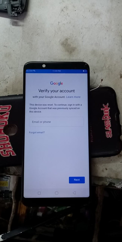

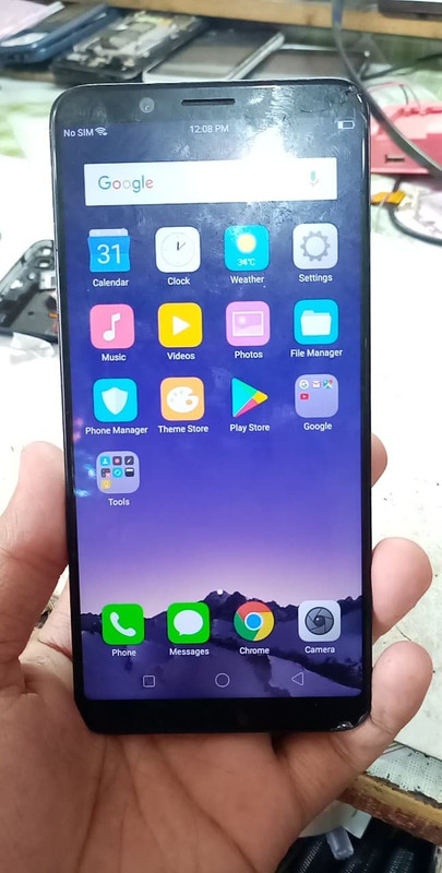

done erasing user data
pag may frp same procedure just tick erase frp
