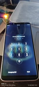

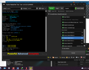

PROCEDURE

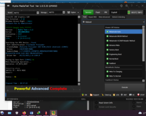

OPEN HYDRA MTK MODULE
BRAND AUTO
SERVICE TOOL REBOOT TO METAMODE AUTO
POWER OFF PHONE
CLICK EXECUTE WAG BOOT INFO
HOLD VOL UP AND DOWN
SAKSAK USB CABLE
PAG NAG SWITCH NA SA METAMODE
PROCEED NA SA PAG ALIS NG PASSCODE
SERVICE TOOL CHOOSE
FORMAT FACTORY RESET SCREEN LOCK
AND CHOOSE FACTORY RESET EMMC 1 NEW
PAG NAG STATUS OK NA WAIT NALANG MAG WIPING UNG CP WALA NG IBA GAGAWIN

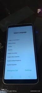

FOR FRP
DIAL *#813#

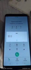

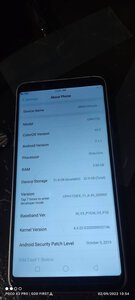

UPDATE KO LNG MGA DOL NAKA NULL IMEI PERO MAY BASEBAND AT SIGNAL
