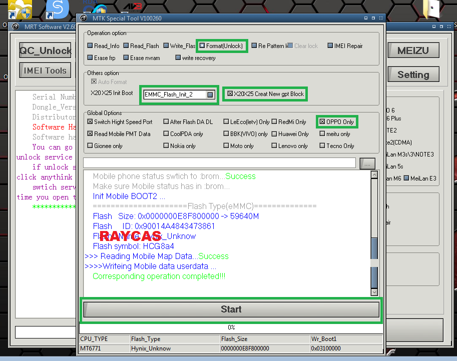

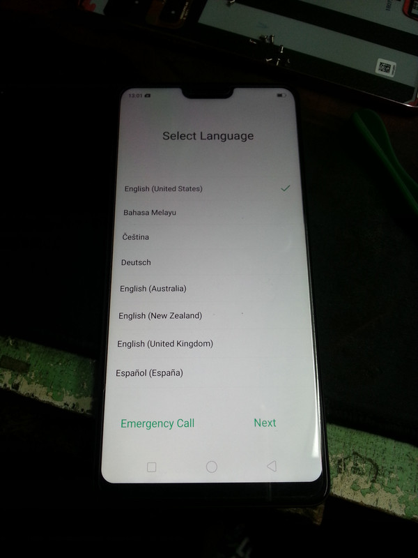

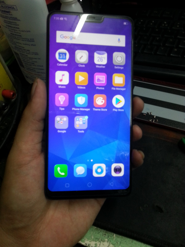

SHARE KOLANG SA INYO MGA LODI NATANGAP KO F7 1819 NAKA PASSCODE DONE BY MRT DONGLE
OPEN MRT SELECT MTK TAB NANJAN ANG RESULTA NA NAGAWA KO FIRST FAIL PERO UL8 ULITIN MO
HANGANG MA SUCCESS
BOOT KEY NI F7 PRESS VOL DOWN AND VOL UP
