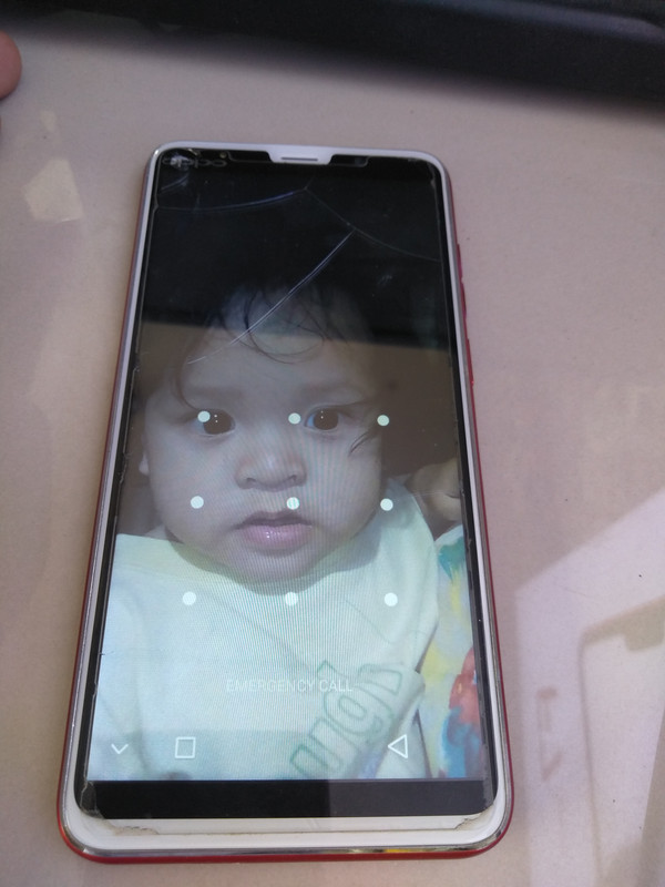

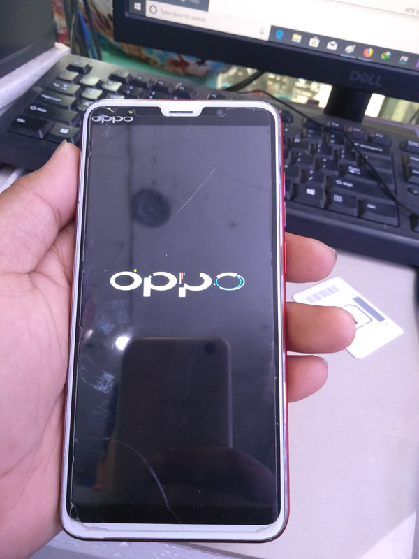

Status ng Phone:
patten problem linagyan ng bata niya nakalimutan.

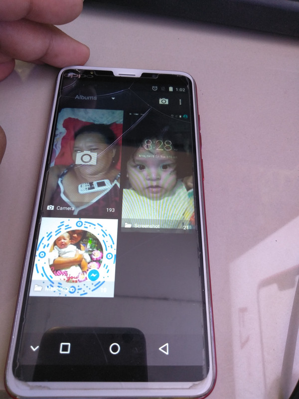

Sabi tumer sayang mga pic wala memory gusto ma save
Ayos namn sucess

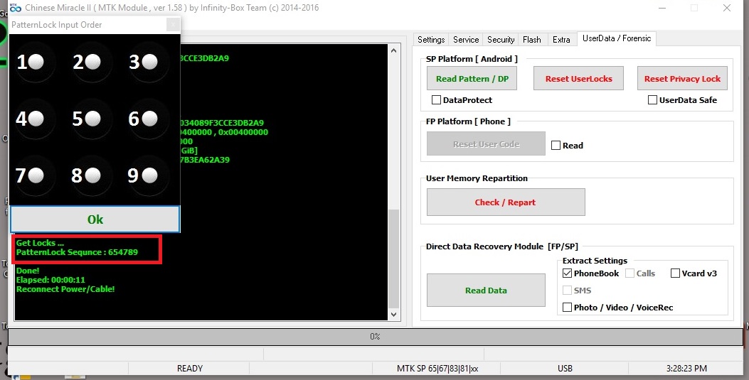

Procedure:
OPen Cm2 mtk
click settings chip select auto 2601 65 66 etc
go to tab user data fornesic
click read pattern
salapk usb walang boot salpak lang
save file
ito ang back up file sa nanganga ilangan ng fw

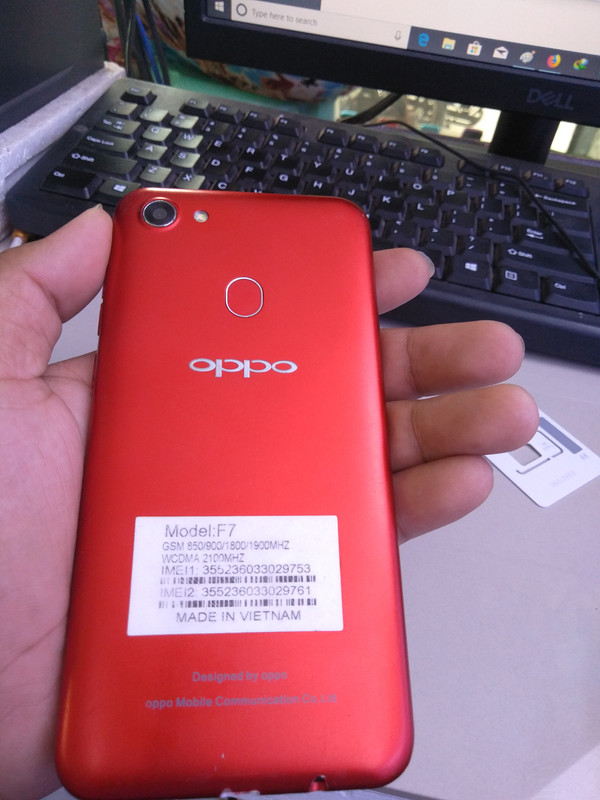

[AP] : Initial info read Ok!
Brand : F7
ProdName : F7
ProdModel : F7
Device : F7
AndroidVer: 8.0
MTKxCPU : MT6580
MTKxPRJ : ALPS.L1.MP6.V2_YUANDA6580.WEG.L_P2
sana mak tulong..
