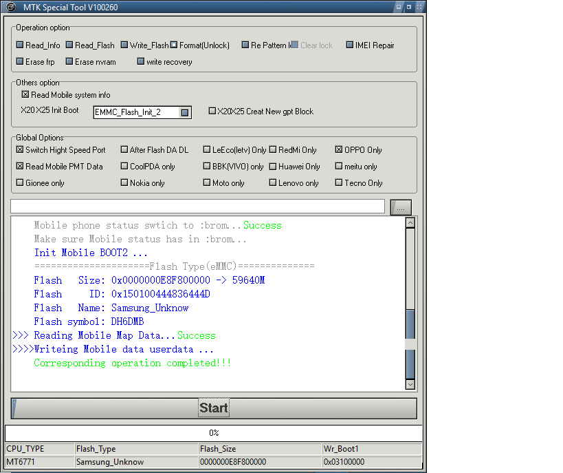

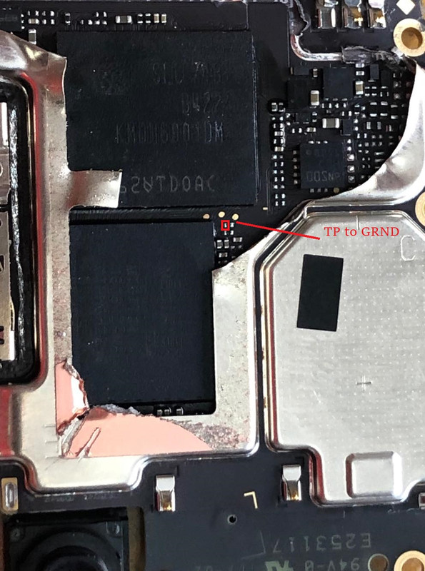

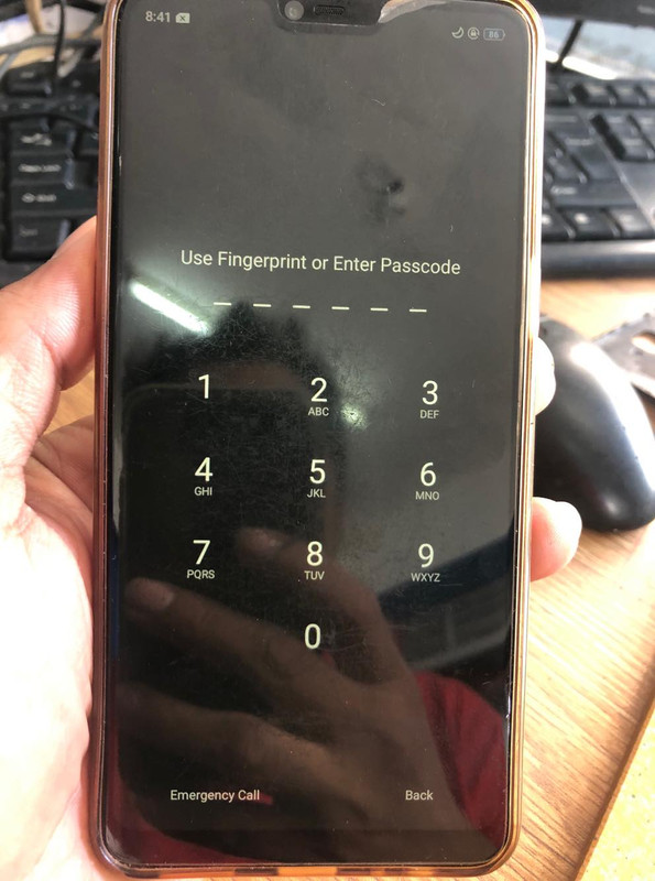

jekerz Registered Joined Sep 22, 2016 Messages 135 Reaction score 69 Points 1 Location SANTIAGO CITY, ISABELA Oct 12, 2019 #1 Oppo F7 CPH1819 Password Done MRT TP Password Testpoint image ru MRT Done....
X xykronix04 Registered Joined Mar 31, 2018 Messages 11 Reaction score 0 Points 1 Feb 15, 2021 #2 boss nag tp puh nid puh salpak battery tapos usb.. puh ba
jekerz Registered Joined Sep 22, 2016 Messages 135 Reaction score 69 Points 1 Location SANTIAGO CITY, ISABELA Feb 16, 2021 #3 xykronix04 said: boss nag tp puh nid puh salpak battery tapos usb.. puh ba Click to expand... kahit hindi pero kung d ok insert u battery
X xykronix04 Registered Joined Mar 31, 2018 Messages 11 Reaction score 0 Points 1 Feb 16, 2021 #4 Ok na puh naqpalit puh ko cable.... Done na puh
