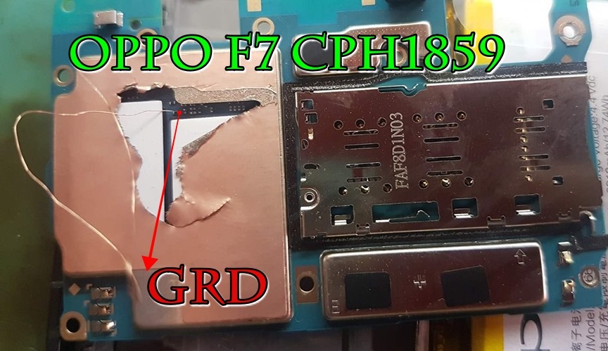

procedure:
open likod ng unit dahil my TP
TP :
no battery
driver mtk insttal ---------> FILE HERE
sundan yung na sa pic
model oppo brand F7
go to service
smart reset
click reset settings/format FS
tapos TP mo na
wait mag done :D...........
