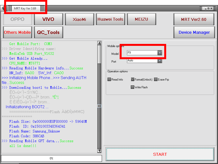

MAY NABABASA KC AKONG MGA COMMENT SA TAHANAN NAMAMATAY DAW AFTER FORMAT SUCCESS PERO DEAD
PERO SAKIN NAGLAKAS NAKO NG LOOB,UNA EROOR AYAW MAG TULOY,,AT SA 2 VERSION AKO NAG TRY NG MRT ERROR TALAGA..

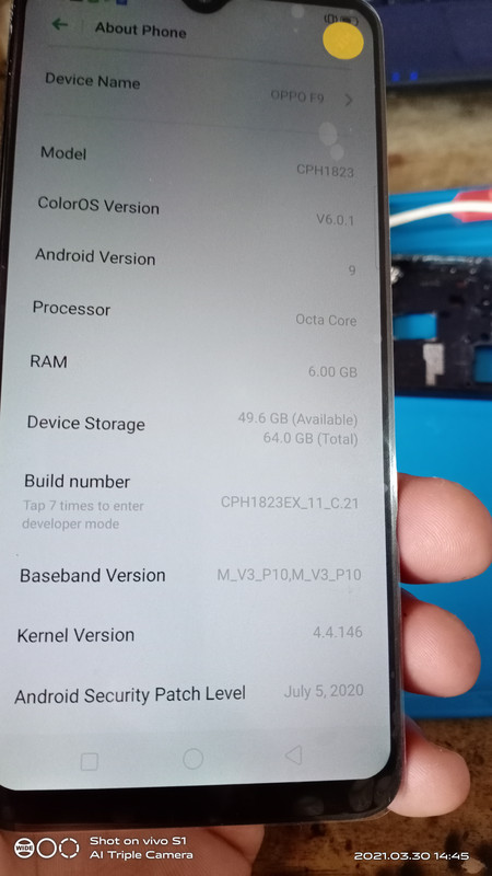

AT LAST VERSION N GINAMIT KO NAGTULOY XA,,ABA SUCCESS..

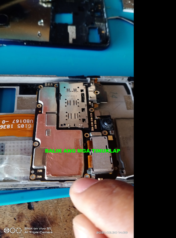

TPOS BALIK KO NA ASEMBLE N ULIT TRY KO CHRACGE MUNA,ABA..NAG CHARGE NMN AKALA KO MAMATAY RN NG KAGAYA NG IBA
PERO THANKS PARIN KY GOD..SUCCESS SAKIN..
ITO PICS MGA MASTER,AT VERSION N GAMIT KO..SUNDAN NA LANG...

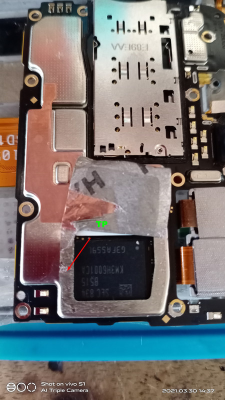

NOTE#TWEEZER LANG GINAMIT KO..AT IWASAN MA BODY GROUND UNG ILALIM NYA PG MG TP N,,
KAILGAN TAKPAN ANG ILALIM,PARA WLANG GROUND..KYA DN CGRU NAGKKA ABERYA ..
