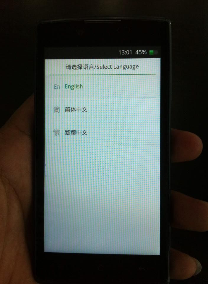

1:
<textarea style="width: 500px;" readonly="readonly" class="ncode_imageresizer_warning" id="ncode_imageresizer_warning_4">Click here to view the original image of 704x960px.</textarea>

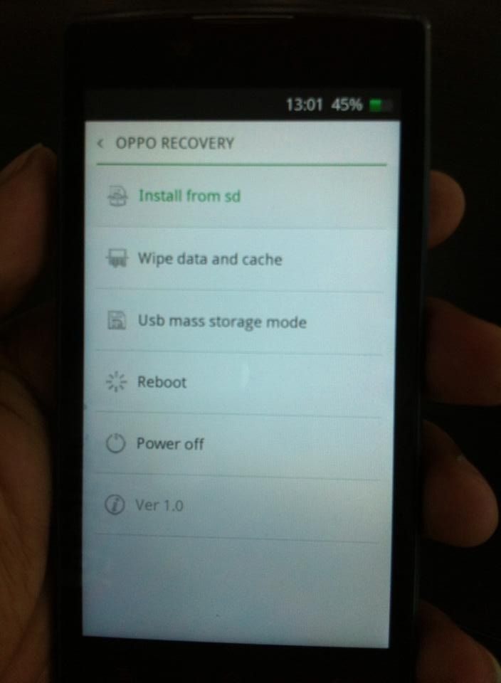

2:
<textarea style="width: 500px;" readonly="readonly" class="ncode_imageresizer_warning" id="ncode_imageresizer_warning_2">Click here to view the original image of 704x960px.</textarea>

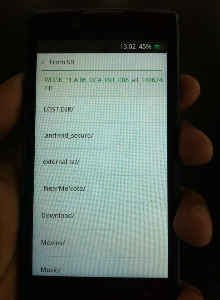

3:
<textarea style="width: 500px;" readonly="readonly" class="ncode_imageresizer_warning" id="ncode_imageresizer_warning_6">Click here to view the original image of 704x960px.</textarea>

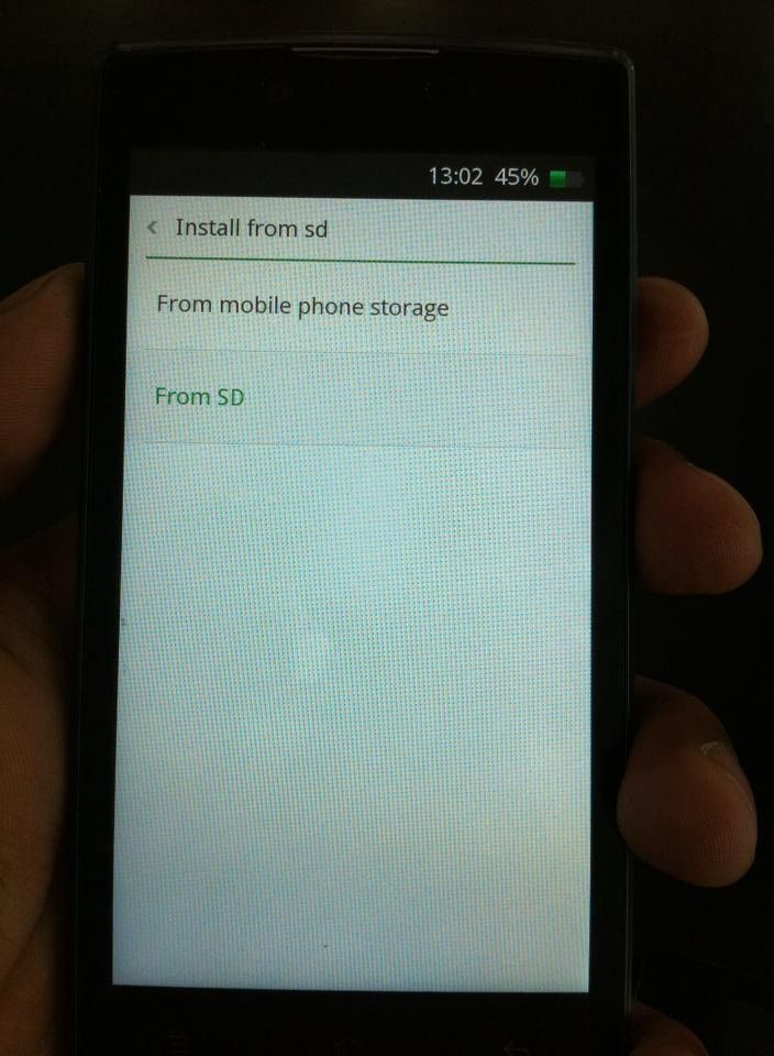

4:
<textarea style="width: 500px;" readonly="readonly" class="ncode_imageresizer_warning" id="ncode_imageresizer_warning_7">Click here to view the original image of 704x960px.</textarea>

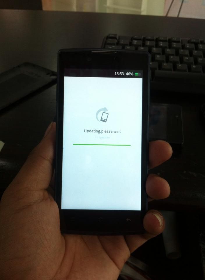

Hintayin matapos
<textarea style="width: 500px;" readonly="readonly" class="ncode_imageresizer_warning" id="ncode_imageresizer_warning_3">Click here to view the original image of 704x960px.</textarea>
