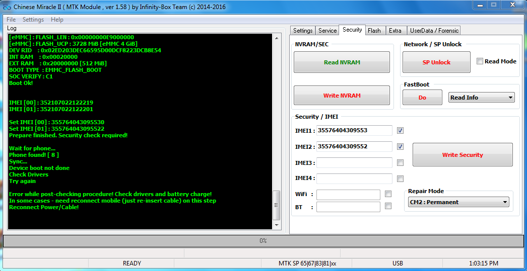

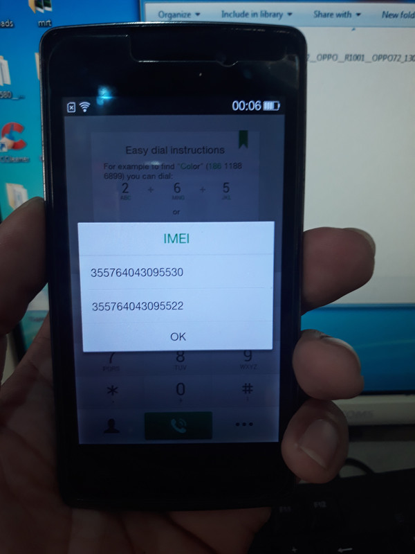

oppo r1001 invalid imei done by cm2
screenshots
procedure
1st copy imei at the back of phone
open cm2 mtk
choose sp boot
go to security tab
type the imei number
choose cmt permaneng
then click write security
insert usb no boot mode
then wait until finis
done
