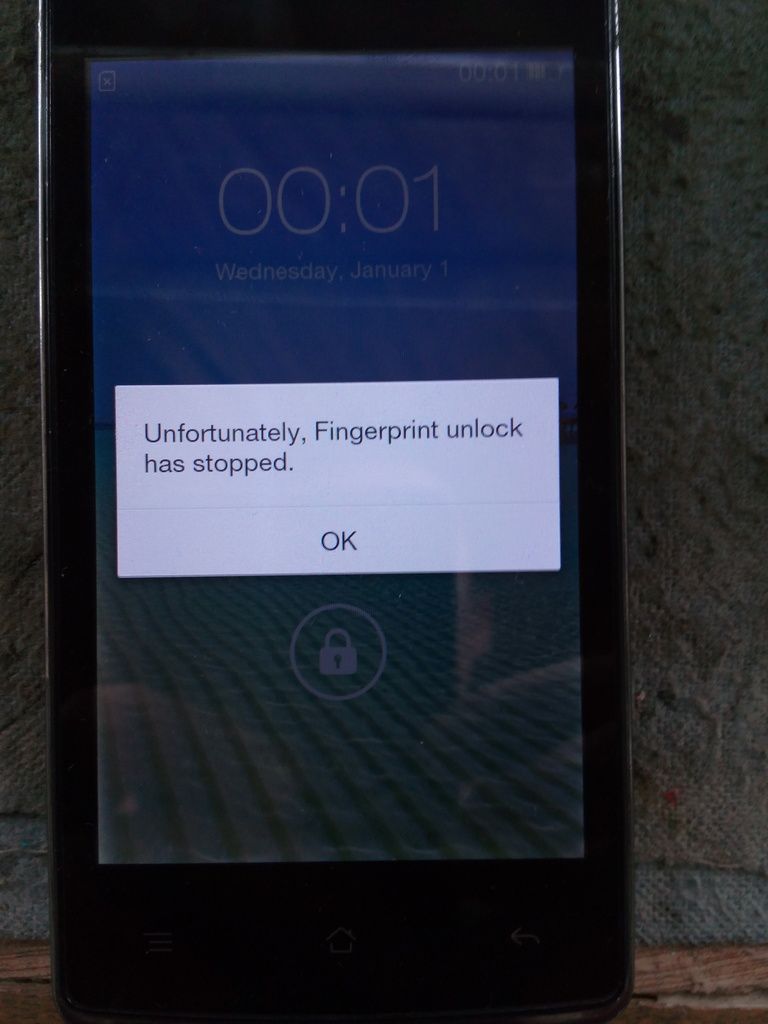

OPPO R1001 Unfortunately fingerprint has stopped
1st tryko muna hard reset but no luck meron parin

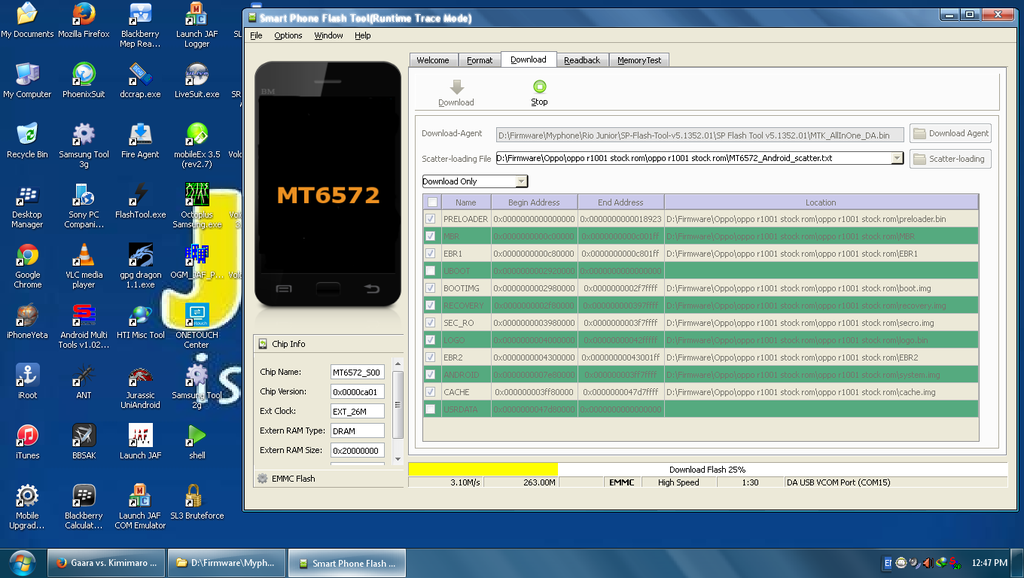

2nd flash na SP flashtool
open sp flashtool select scattered then hit donwload
remove battery sa phone then salpak ulit
hold volume up then salpak usb cable
wait until done!

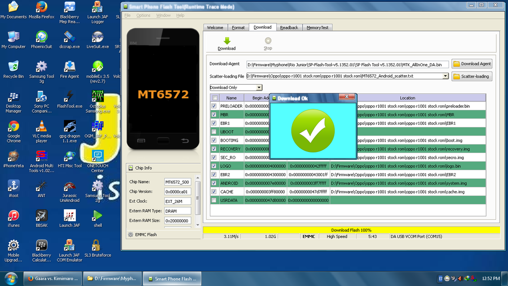

ito po ang pics.....
ito po ang firmware
http://www.4shared.com/rar/IkQ9tt6Lba/oppo_r1001_stock_rom.html

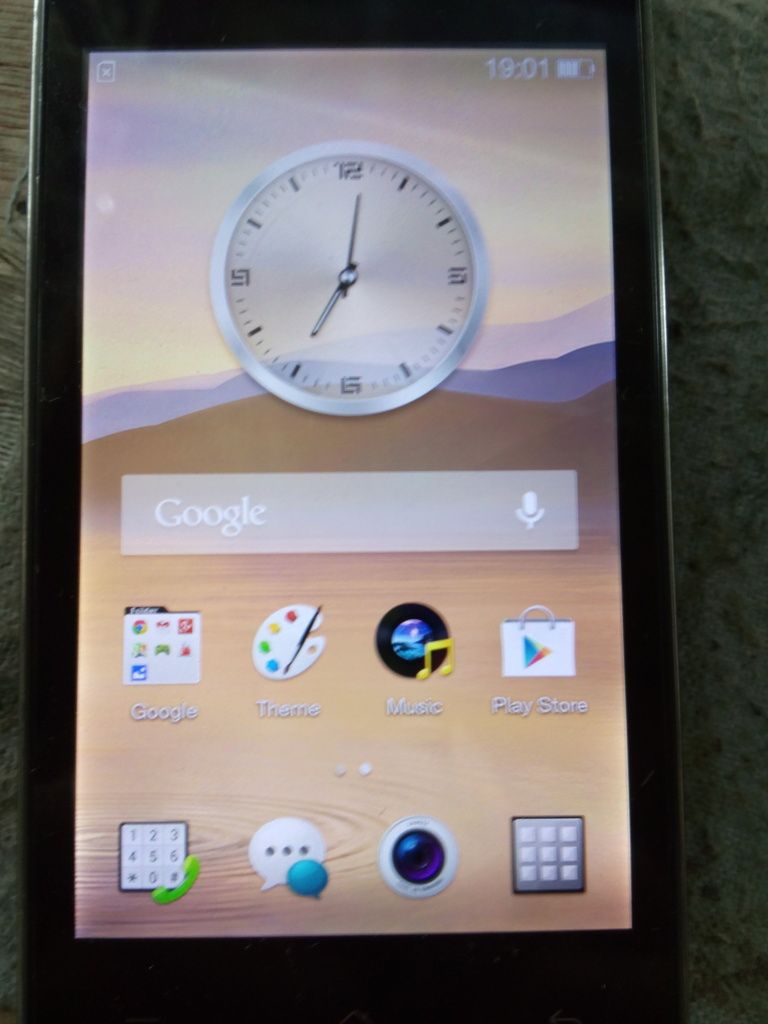

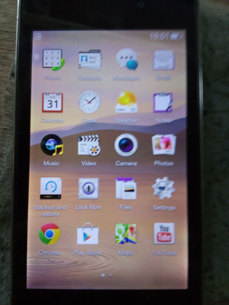

done na po.....:)):)):)):)):)):))
