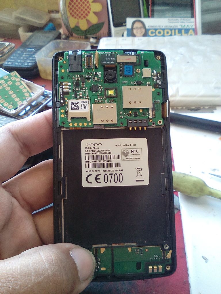

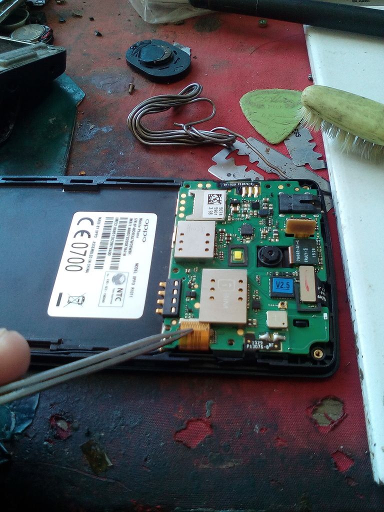

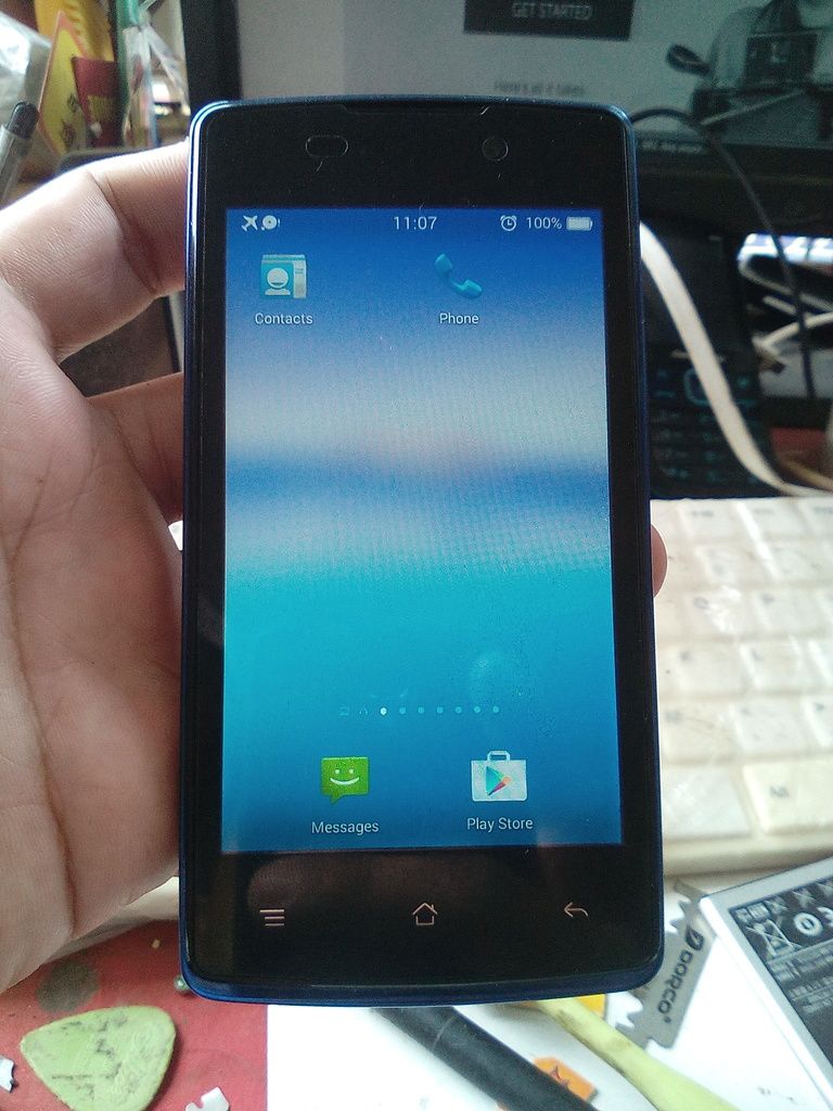

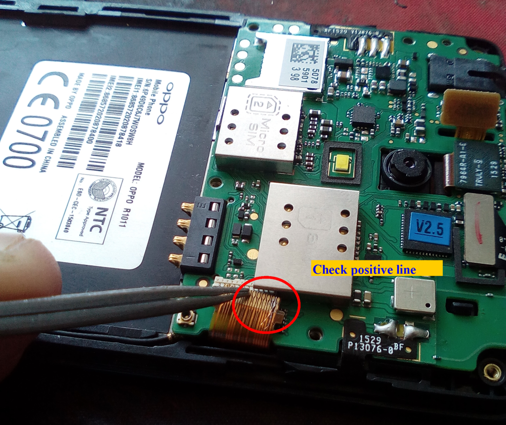

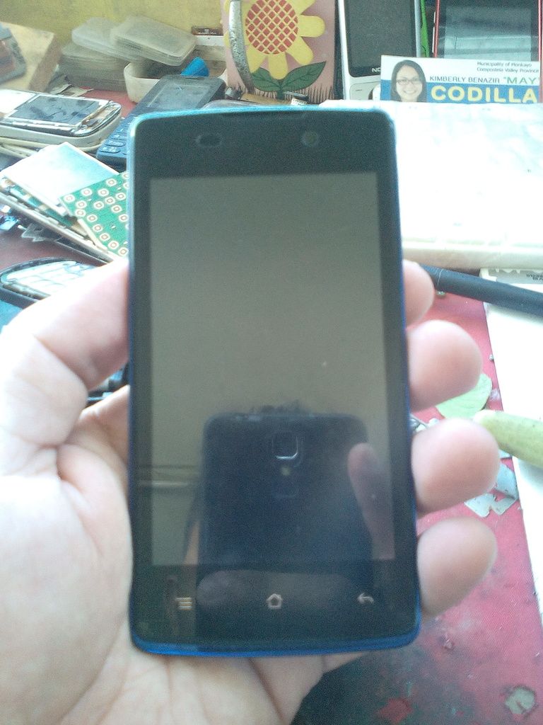

Nayr85 Registered Joined Mar 28, 2016 Messages 348 Reaction score 29 Points 31 Location Davao City Mar 29, 2016 #1 check sa flex po check sa linya ng lcd light ayon may nasunog kaya walang light kasi naputol po. make jumper agad tapos power on it the phone check kung may ilaw na sa wakas its done salamat god blesses at all.
