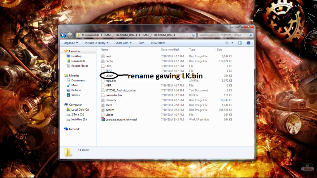

Flash Ko Sa Flash Tool Dead Vibrate Na Lang
Kaya Pala Nag Vibrate Na Lang Dahil Wala Uboot Ang File...
Here's The SOLUTION Open Folder Kung Nasaan Ang File Ninyo At Gawin Ito
Sa File Kasi Na Yan LK Lang Po Ang Naka Lagay Dahil Ang Lk po Ay = Ng UBOOT
Proceed Na Po Ako Sa Flashing

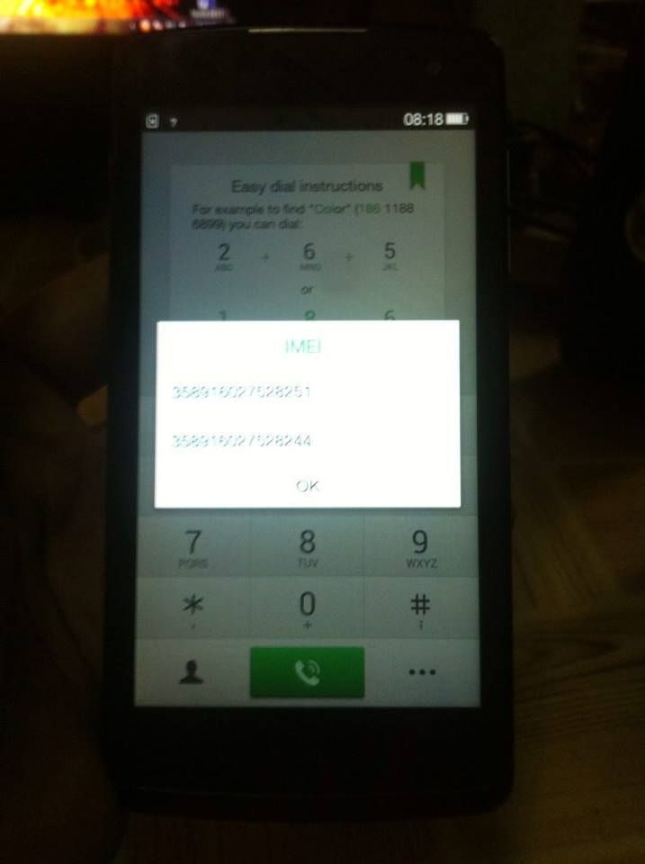

Pag Open Ko Po Invalid IMEI Ayaw Madetect Sa NCKBOX At VOLCANOBOX Ko
Kaya Po Download Nito At Install
https://drive.google.com/file/d/0B1mq9ajwSLFIVWdvZU5EcnppNDA/view?pref=2&pli=1
Intructions Sa Pag Palit Ng IMEI Madali Lang Open Lang Yan Then Type IMEI Then Reboot
Eto Po Ang Finish Product Pasensya Na At Malabo

try mo po boss tignan mo kung pag flash mo walang uboot at tignan mo yung sa file folder kung may LK at irename mo po sa LK.bin auto po kasi yung pag select mo scatter mapupunta sa uboot ;))
