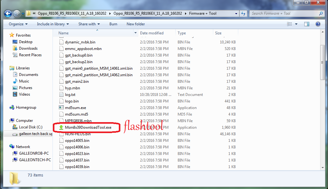

may kasama na po yan na flash tool
2.) sa loob po naNg folder makikita nyo po yung flashtool

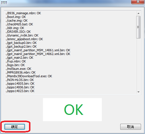

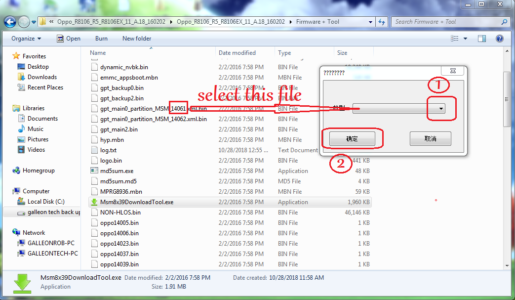

3.) select nyo po 14061

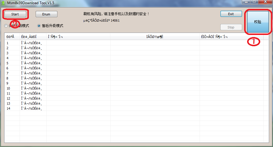

4.) CLICK THE SELECTED BUTTON ON THE PICTURE THEN PRESS VOLUME AND VOLUME DOWN BUTTON SA CP THEN INSERT USB CABLE.
5. CLICK START BUTTON PAG CONNECTED NA PO YUNG PHONE IN QUALCOMM MODE.
