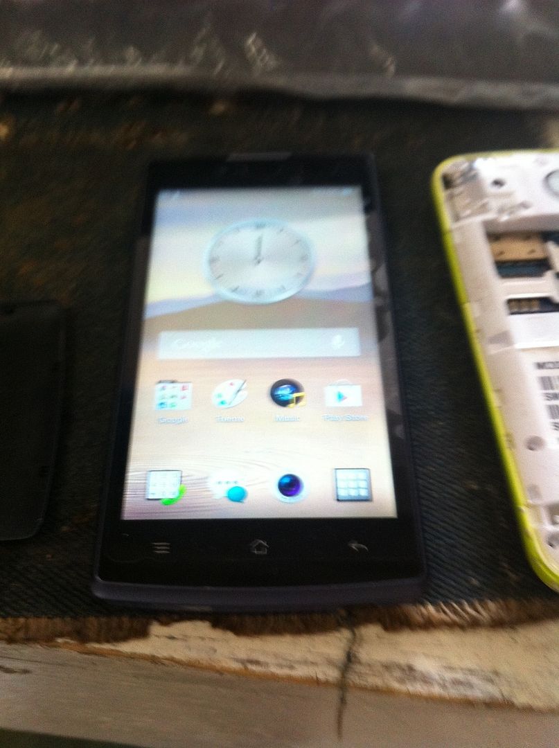

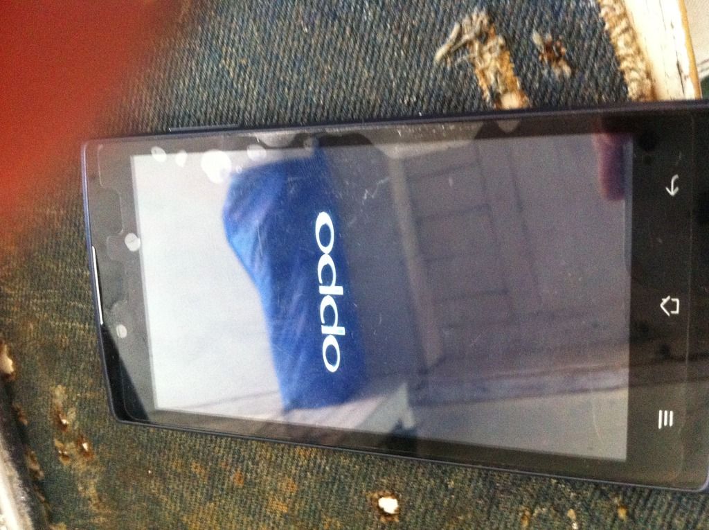

MGA BOSS SHARE KO LANG NAGAWA KO OPPO R831K HANG LOGO PROBLEM
SABI NG CUSTOMER BIGLA NA LANG DAW NAGKA-GANUN.
KAYA TRY KO SA HARD RESET PERO GANUN PA RIN
KAYA HANAP AKO NG IBANG WAY PARA MALUTAS PROBLEM NI TOMER,
BUTI NAHANAPAN DIN NG SOLUTION.
ITO NAKITA KO FIRMWARE PARA DITO,KAYA DOWNLOAD KO AGAD,
SA UNA HINAHANAP KO SCATTER FILE, PERO WALA AKONG NAKITA.
TOOLS ; 2GB MEMORY CARD
ITO PROCEDURE JUST DOWNLOAD THIS-----https://www.mediafire.com/?xa493vp3rdgbp91 /

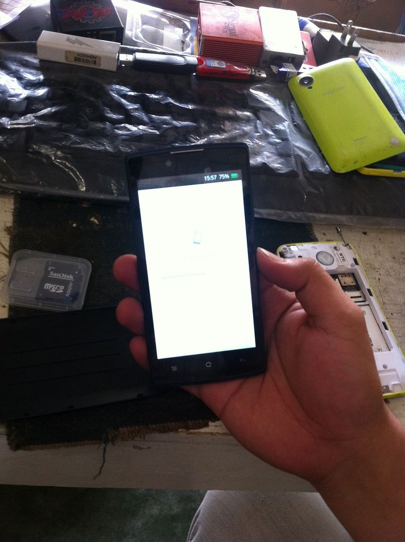

PAGKATAPOS ILAGAY SA MEMORY CARD,
PUT THE PHONE TO RECOVERY MODE,PRESS VOL+,POWER ...
SELECT WIPE DATA AND CACHE

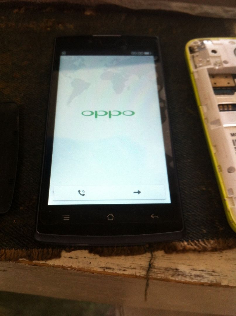

PAGKATAPOS INSERT ANG MEMORY TO PHONE,
THEN PUT TO RECOVERY, SELECT INSTALL FROM SD,FOLLOW INSTRUCTION.
....BUTI NAG-SUCCES DIN.
